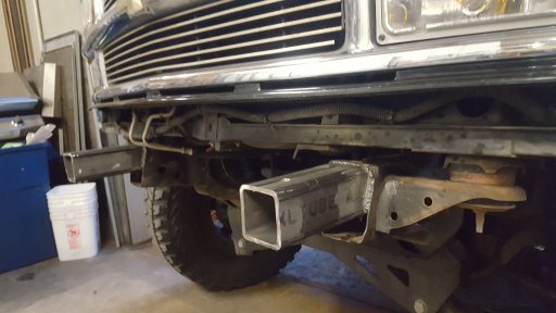

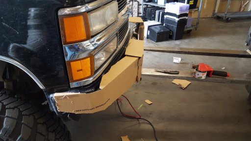

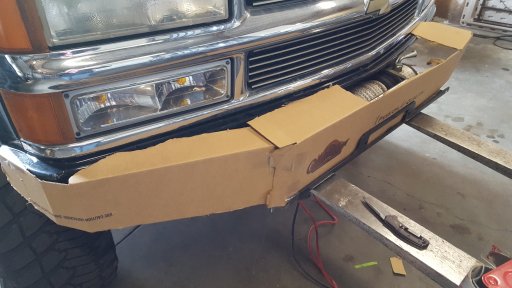

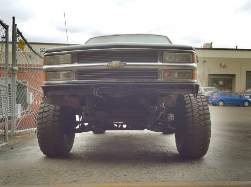

After doing a bunch of measuring I think it would be more work to make the winch fit behind the stock bumper then it would be to make a new bumper .
Plan B.

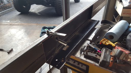

Well the first step in any bumper bill was a course taking off the stock one always look so silly with no bumper

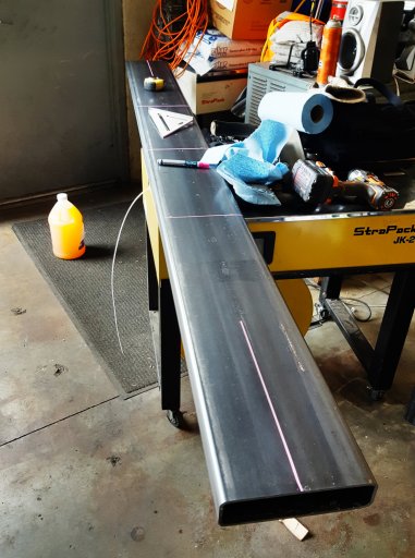

And I started making my base measurements figuring out where I need to cut holes for the winch to sit inside the plate and where my bends are going to behdr_00686_0.jpg

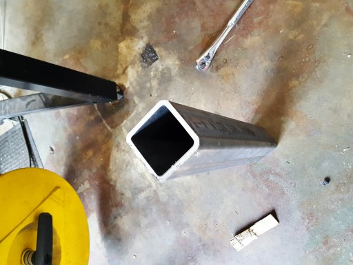

Plan on using 3x3 1/4 wall for the stringers coming out of the frame to the winch plate hdr_00689_0.jpg

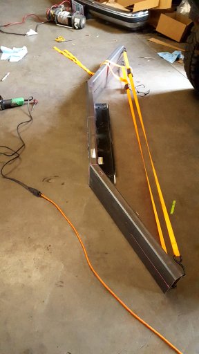

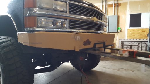

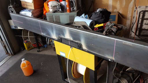

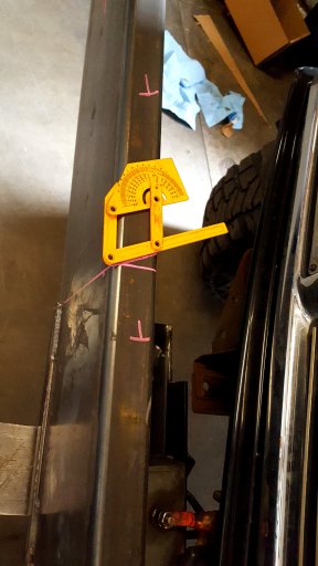

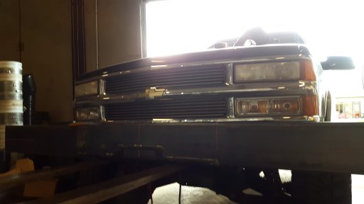

A quick burn of the winch plate and bumper material and it's starting to take shape 20180302_152348.jpg 20180302_152340.jpg 20180302_160540.jpg figured out I needed a 25 deg bend to get the shape i wanted 20180302_160056.jpg 20180302_163539.jpg
I only had a couple hours to mess around with it so that's as far as I got , next step will be bending it around the sides and doing a lot of cutting to get it slimmed down a bit

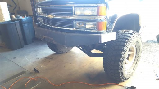

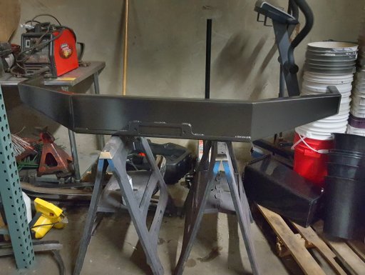

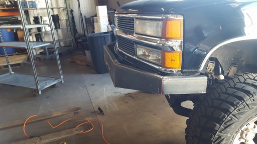

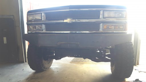

Well got the bumper mostly done and the frame mounts built , still need to plasma out the farelead hole but all in all its done .
