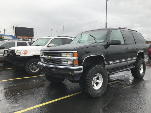

I finally figured out a name for this thing Kronk . If you have never seen the movie emperors new groove go do it ..... right now . we came up with the name because it's big , dumb but reliable and when I got it everything in the suspension squeaked and it reminded us of Kronk speaking to a squirrel.
Wasn’t planning on buying this thing was actually just going to take it for a test drive to see if a Tahoe would work as a replacement for my sequoia ( btw the sequoia is for sale ) but the gf bought it for me so how could I say no??? We are looking to buy a house in the next year so we are cutting back on a lot of stuff and two of those expenses are the sequoia and my boat
But back the the Tahoe , already has lift and good tread 35s on it , only 124k on the clock , leather with heated seats , rear ac and my favorite thing rear barn doors !!! So this will be more maintenance items and building bumpers taking it out exploring kinda thread .

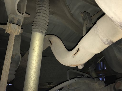

Had a few hours free today and managed to get some things taken care of.

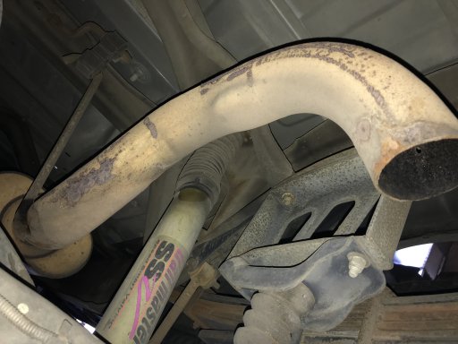

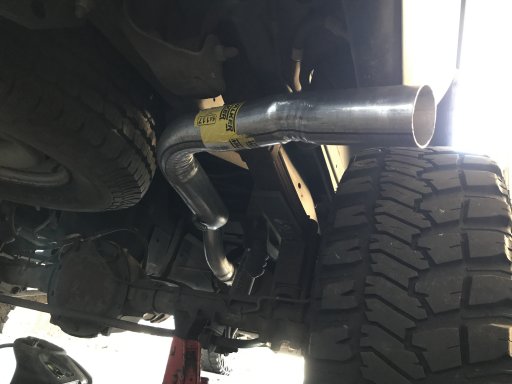

First off was the Exhaust it was rusted out and cut off right behind the muffler so it was resonating in the cab a little .BB4269CB-A363-4F9F-86BE-B6A7C7AB1759.jpeg
Now this pipe goes to show you the difference in pipe quality , everything before the muller is fine and I’m sure is factory . Lot of times when you get a lot cheaper quote on exhaust work it’s probably because they use cheap pipe and mufflers . The thinner the pipe the more sound will end up inside your cab and not out the tailpipe.

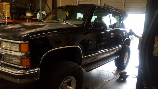

79FBD2AB-F4D7-4700-8124-6A3650857555.jpegIt’s not tucked up as far as I want but I just needed it fixed for now because it will get rerouted when I build a bumper . Kinda sucked because I think the battery in my welding mask is going out because it was only darkening half the time so I ended up doing one crappy not looking at it welds but no leaks so that’s all that matters .

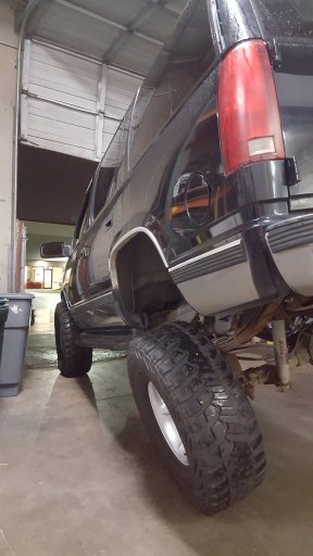

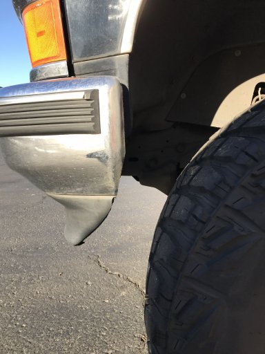

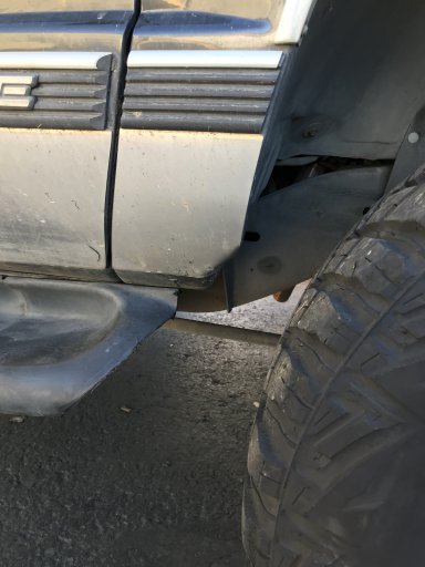

Played around with the torsion bars a bit nd hopefully have it set at good spot where the cvs aren’t at much of a angle, also got the bumper and pinch weld taken care of so there’s no more tire rubbing 72B0B4F9-6828-4C7F-BCAC-FF14605ACE2D.jpegFF320126-2715-4C97-B392-D31AB9438BF5.jpeg

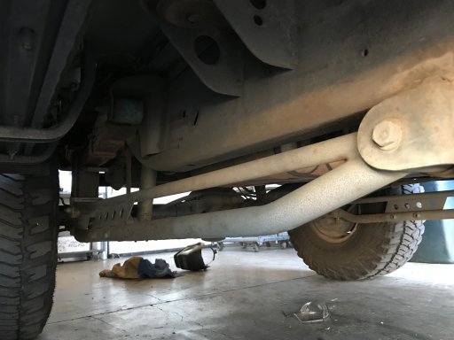

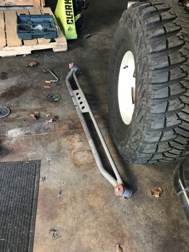

Last thing was pulling off the traction bars , rides so much better now . Might have another use for these things B68FF7AF-811E-4A62-AB86-537749C06C19.jpeg

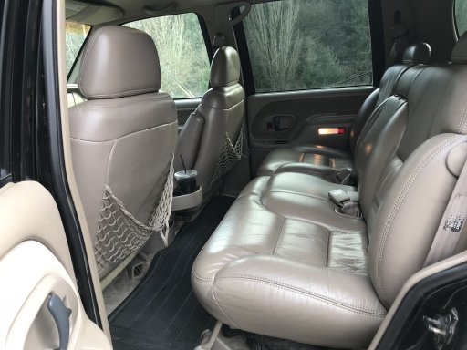

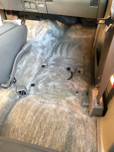

Today’s project was getting the interior cleaned up a little , it’s still amazing to me how many different things you can use simple green cleaner . If you dilute it quite a bit it makes a great carpet cleaner . I don’t have my handheld carpet cleaner anymore so a bucket of hot water scrub brush and some clean rags can get most all the stains gone .30C4AF29-2240-4A71-AC3B-988CD9AD6C07.jpeg

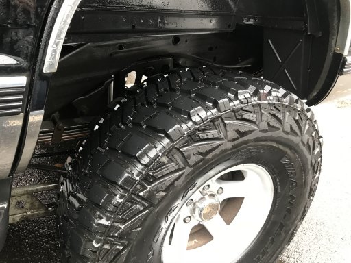

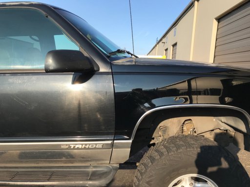

had some down time waiting for a truck so the munchkin and I managed to get the Tahoe polished a bit 9589E1EC-6F07-4E40-BDEF-C8D6F8B58F24.jpg

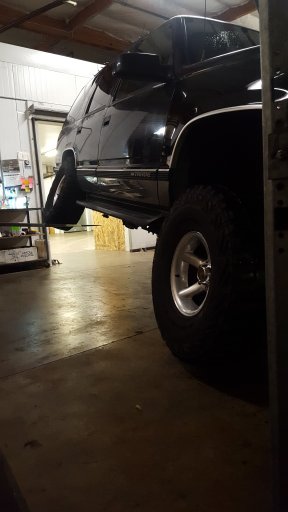

Pulled of the rear sway bar , definitely need longer rear shocks and ditch the add a leaf and the overload spring ( I'll run airbags for towing) 20171218_180846.jpg20171218_180807.jpg
So far I'm super happy with it just need to address some maintenance items b4 I wanna take it off the beaten path exploring

Well I still haven't had a chance to go out in the Tahoe and test it , took it up to go snowshoeing but that's about it . Got some more maintenance stuff done , put in new upper control arms and lower ball joints .

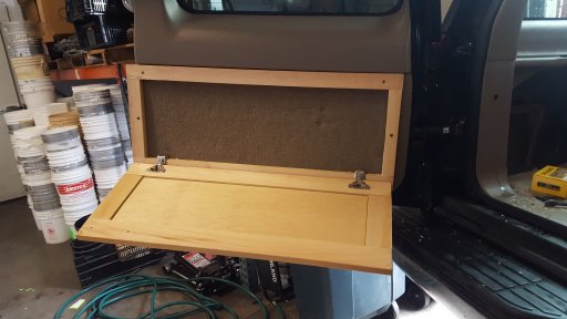

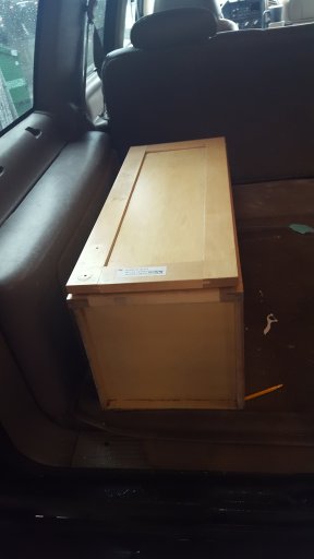

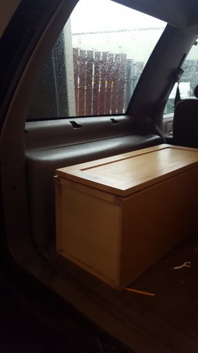

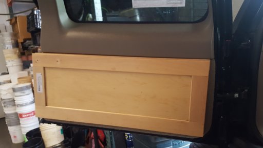

Happen to stop by a local habitat for humanity re-store shop , wanted to see what they had to hopefully pick up some odds and ends for wedding decorations but they really didn't have much in old wood or clocks ( fiancé wants to do like a drunken mad hatter tea party with miss matched China and clocks ) but they where having 50% off all cabinets soooooo I picked up a skinny cabinet hoping to use it as a built in box over the wheel well .
It ended up being a little to wide but it was the perfect size for a fold up shelf on the barn door , needs some trimming and some cables or chains to help hold it up but for 6$ I call it a win and if it doesn't end up working oh well it was 6$20180109_125011.jpg

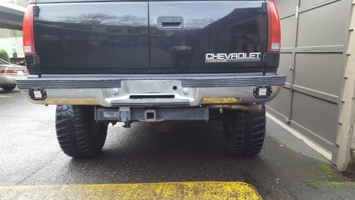

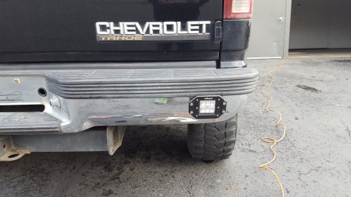

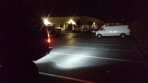

The backup lights on this thing are just about worthless so I picked up some super cheap flush mount led lights , I usually hate buying cheap Chinese import stuff but with the high chance these will get broken I'd rather go cheap 20180119_134332.jpg

Been super busy with work and doing some reorganizing and downsizing at the house but I managed to do a little lighting upgrade between trucks
My windows are tinted and being lifted my stock backup lights where crap so I got some cheap led flush mounts 20180203_224106.jpg
