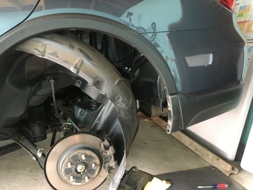

How hard was it to install the LP Bypass Canister kit? I have no idea where the stock one is in the car.
It's pretty easy/straightforward. These pics should walk you through it but feel free to DM if you have any specific questions.

So to replace the grille I had to remove the bumper guard, front skid plate, tow hook, and the entire bumper cover... Not going to lie Subaru, it should be easier than that haha.
It was a great opportunity to delete the OE daytime running light module which uses the high beams running at reduced wattage. I've never liked that because it dictated what bulbs I was willing to run. The original headlights/fog lights were all underwhelming. I have long since been running adapted H9 fogs in place of the stock H11 bulbs for a nice bump in output. Installed HIDs in the low beams that I'm still in love with. To get away from the dingy 9005 high beams I installed pricey LEDs that I've hated since day one. I've had to endure every shortcoming that exists with the current design. They're super bright but the throw is awful and the only thing all that brightness does is glare everywhere. Good riddance as I was now finally able to adapt and install HIR1 (Halogen Infrared Reflective) bulbs which are 1200+ lumens brighter than 9005s. So happy to have great street legal long distance lighting.

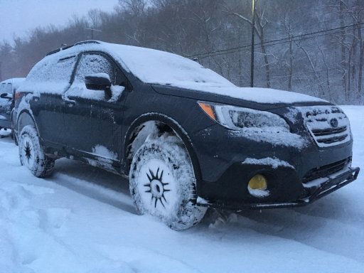

How would you rank the AT Geolander G015 in snow? The current all-season tires I have on my MDX are OK in the snow and I'm considering going with 2 wheel/tire setups (all-seasons and winters) or just a year-round solution.
Thank you! The aftermarket support for off road Subaru's is getting better as more and more people are getting their cars dirty. That said we're still left to figure out a lot of stuff on our own.
In regards to the G015s, they do very well in the snow. Admittedly a lot of credit goes to Subaru's AWD but even in the +2' blizzard that hit us this year I was out and about problem free.
