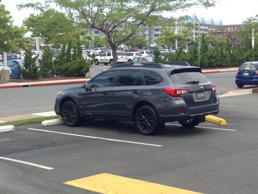

I purchased my 2015 Outback to be a daily driven, AWD fear no snowstorm, utilitarian, quiet, shrug off speed bumps vehicle that ran on 87 octane go go juice. We have 2 other vehicles that can't check off all of those boxes, one none. My first Subaru. It's been a great car that came with 8.7" of clearance that has logged miles up and down the east coast several times and done so quite efficiently. Even loaded down and running the AC the car typically returns ~32 mpg. On to the pics which I'll have to admit I don't pretend to be a photographer and rarely take pictures to begin with.
Here it is pretty much when it was new. Looking just like the Outback littering all of your neighborhoods but really enjoying it's paws in the snow.
I had plans before I took delivery of the car and had a pile of things waiting for it. I'm not a fan of chrome or really anything bright except when it comes to lights. So I almost immediately debadged the back, blacked outs anything chrome/bright, and swapped out almost every single bulb in the car. HID lows, PIAA 3k fogs, and LED everywhere else including the high beams. Also added Rally Armor flaps, wheel arch moldings, and tinted the front windows to match the OE rears.

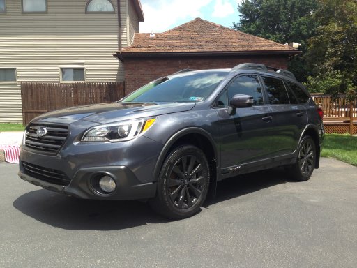

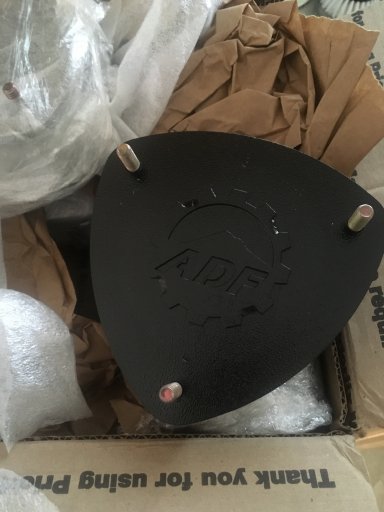

At this point the seed was planted and I felt the need to add more air underneath the wagon. Anderson Design and Fab to the rescue. The order from ADF added 2" to the front and 2 3/8" to the rear. I should add that I love powdercoating parts and I also love the color black.
I love everything about it. It even makes it easier for me to get into and out of as well as when I place my sons car seat into the base. Practicality, functional, and it looks good... except for those OE wheels and tires. Hello Mickey Mouse.

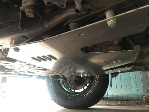

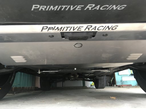

The next step just makes sense and since it's still a daily driven car I thought it best to protect its sensitive belly. Enter another small American company, Primitive. Here's the car wearing their snow shield and front skid plate.
Mid/transmission armor.
Dif armor.

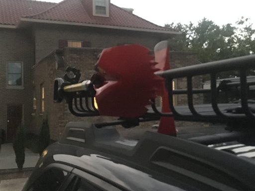

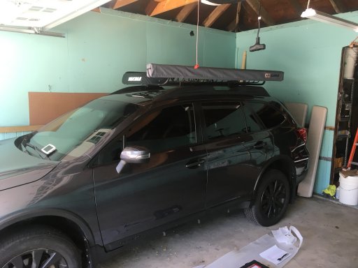

Next up is my ARB awning. It's not made in the USA but the Foutreks mounts that hold it on the Loadwarrior are. Did I mention my Outback was made in Indiana?..

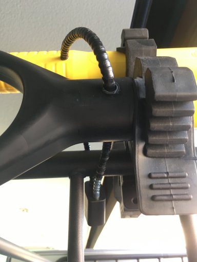

Tool time compliments of Fourtreks again. Room for 3 or versatile mounting for 2. In keeping with the theme both the #Murderspork and Pulaski are made America as well.
In an effort by to keep people honest a repurposed cable lock.

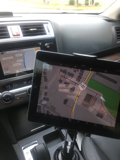

For navigation I'm using a Dual 150 external gps, a dedicated iPad with Scenic Map as well as Gaia, and an inexpensive yet well functioning ikross mount.

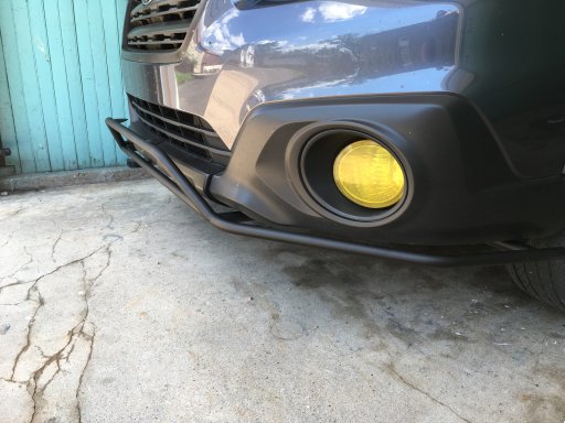

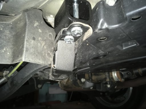

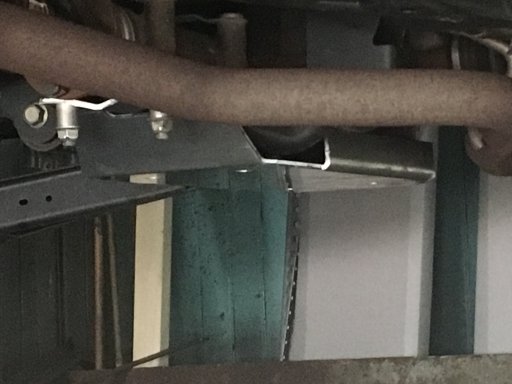

Next up was some great parts from our friends to the north and LP Aventure. First up is a brush guard that's a lot sturdier than most people would imagine. One of the weak points of the Outback off-road is its long nose. The brush guard doesn't help that but I'm not ready to go custom bumper yet so some protection is in order.
Some support plates/sliders for the rear.

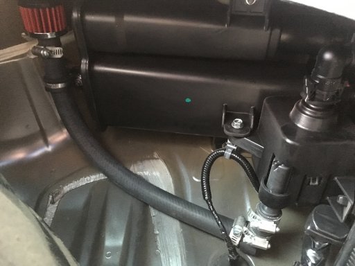

EVAP canister bypass to help avoid problems if the water gets deeper than planned. This places the vent high above the rear wheel behind the wheel well liner.

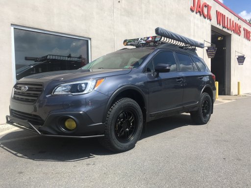

Speaking of wheels it's time for some AT tread.
Yokohama Geolander G015 wrapped around super light yet super strong Enkei RPF1's. So here's how the car looks today. Still have plenty of plans and will update the thread as I go

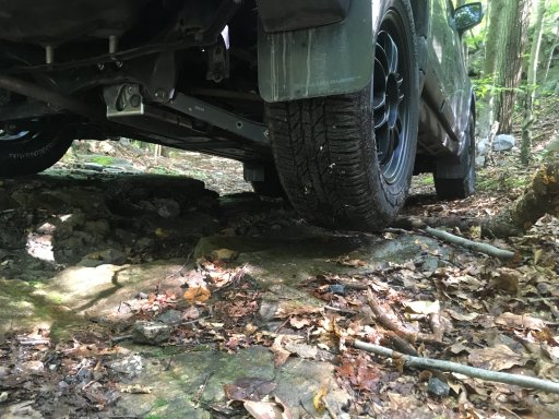

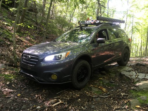

Hit the trails with my brother and his X. The Subaru performed flawlessly on all sorts of trails and I have to say that X-mode is pretty awesome when you bolt the right tires to the car.

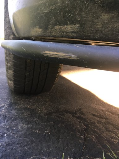

"Brush" guard did its job today. Weight of the car against a rock and I thought for sure it was going to be more than gouges in the powdercoat.
Hey there dif armor! Had a wheel a lot higher several times but it was teetering on two on a steep decline here. Almost perfectly balanced.
Pin stripes galore. My car has a date with a buffer but had a great time getting out there and seeing how capable the car truly is.
We were on trails all day and it was definitely a learning experience. I have a bunch of GoPro videos to go through and I need to remember to take more pics because I know I missed quite a few great shots.

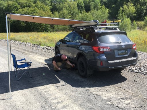

Ok so here's some of the amusing things from the day..
1) I got to use my Pulaski.. a lot. These trails hadn't been traversed in a long long time so plenty of down trees and the aforementioned pin stripes. Chain saw next time haha.
2) I didn't use my machete once.. cause it was at home. A lot of these pin stripes could have been avoided. Ugh.
3) Went through some really good sized water/mud holes in the trail. That was awesome.
4) Pulled something into the left rear caliper and or dust shield going through the deepest of said holes. Had to pull the wheel, caliper, and rotor. Oh the joy.
5) So excited to hit the trails I forgot that I need new tools in the car to remove the new lugs. Good one Drew..
6) Chalk another one up to being excited.. Forgot to pack the jack platform so the jack in the car doesn't stand a chance at getting a rear tire off of the ground. It's cool though since the one from my brothers X lifts higher. Lucky me.
7) ... with the rear sway bar removed the rear has too much travel for his jack. Going to need a rock to set the jack on.
8) .... going to need a bigger rock. When we can't find one the #murderspork came to the rescue. Real easy digging since that's a quarry road and those track marks are from a D8 haha.
9) One more awesome use for the awning. My brother wanted to see it anyway haha.
Good times and lessons learned.

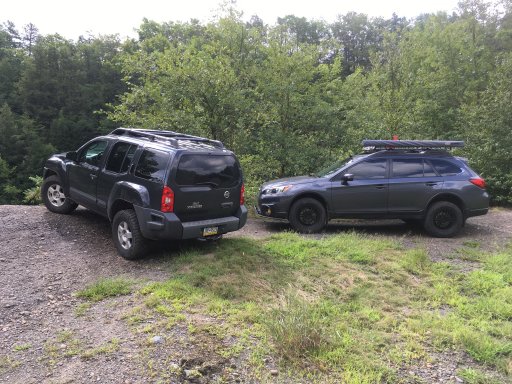

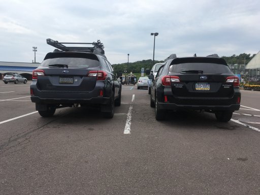

I was given an opportunity to park next to a bone stock Outback yesterday. Looking at the picture it's hard to imagine the car on the right has a respectable 8.7" of clearance. I'm not saying my car is a monster truck but it looks tiny haha.
