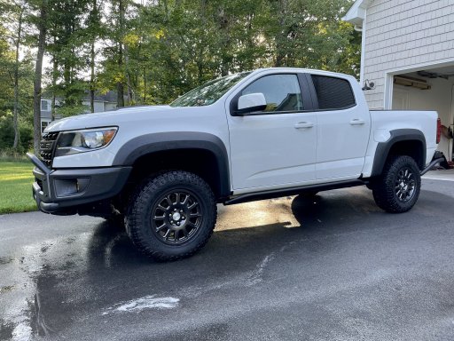

Well I figure the time has come to close one chapter and start a new one. My new Bison has already undergone some changes and it’s already proven to be an absolute billy goat off road. I will certainly miss the Subaru’s mpg but this thing has reignited the passion. Thanks to everyone who followed along but it’s time to start a new build thread...

Nice! I went from an Outback to a GMT700 (GMC Canyon, not as cool as a Bison, but still) and realized how much low range does for ya. Can't wait to see the new build thread.

Congratulations on the Bison! Those things are awesome!
Sorry to hear about the body shop headaches though. My 4Runner is in the shop again now after poor repairs done in 2019 from a wreck. The poor repairs Soured it for me as well over the last two years and we almost traded it for a new one but figured I'd let them have one more attempt at getting it back to how it was before the wreck. Little gremlins and small annoyances can really ruin the rest of the fun so I don't blame you. Plus!! This Bison is such a great platform.
Time to learn to embrace the cliche "Smiles per Gallon, not Miles per Gallon"

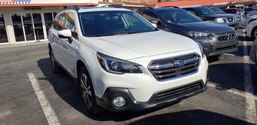

I am in the process of buying a 2023 Outback Onyx. I was convinced I wanted a Green one, but after seeing your white one, I think the white one I have coming will be perfect.
I assume yours is stock height? What size are the KO2s? How bad did they effect your mileage?
I love the look of your car, very well done.
