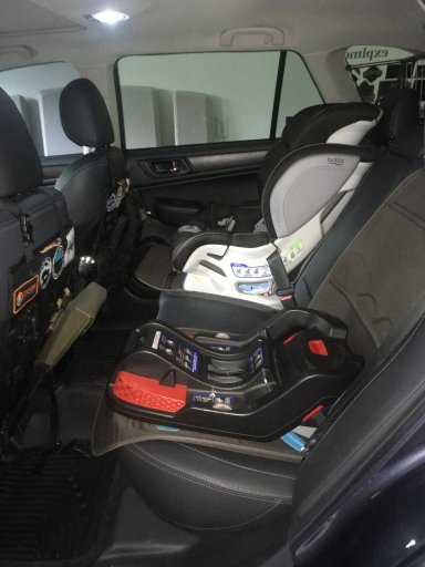

This is such a great build! We're in the process of narrowing down options for a daily driver/overland vehicle that will comfortably support 2 car seats and an aging dog, and I think this may be a great ride for us to copy. I just binge-read the threat, so sorry if I missed it, but what kind of MPG are you getting fully loaded?
Thank you! Sounds like you’re in a very similar situation. This was Monday and the only thing missing in the picture is our 13 year old dog haha.
The best mileage I can hope for is 25 mpg and I get that at lower speeds (55-60 mph) to and from work. Fully loaded I get 22 mpg on the interstate which is a far cry from the 32 mpg I used to get. The car has plenty of power but it’s just the huge aero drag killing the efficiency. It’s still better than anything else with this much clearance though and it’s still quiet and comfortable.
Oh man, after seeing this photo, this setup is for sure in my future. I've got a ~40min commute, so as much as I want a 4Runner just thinking about their mpg (especially after modifications) makes me want to cry as I light money on fire lol. Our kids look to be about the same ages/sizes - I'm assuming you're not running into comfort issues with two car seats in the back?
Seriously, beautiful ride, and great thread. I'm so stoked that I stumbled upon your build, and I'm glad you can't stop me from copying it hahaha
Thanks again. I’m sure I’ve said it before but it obviously has its limitations and anything you do to mitigate those limitations will adversely affect the reliability. For example at 65k I currently have a passenger front axle starting to go bad and a driver front strut mount. I’m lifted higher and routinely take more difficult terrain so things like this are expected. Another thing to understand is that Subaru really leans on electronic nannies to get the most out of its current AWD. There’s a lot of misinformation out there regarding this and you’ll see ridiculous comments like ‘the cvt pulls power to protect itself’. Taking a new Subaru really off road is a learning process and once you accept how traction control that you can’t completely disable works you can go amazing places drama free. I’m not trying to dissuade you in any way but just know it’s not as simple as 4lo and go.
The back seat area is quite spacious so no we don’t have any issues. I’m 6’01” and my daughters rear facing infant seat fit behind me without having to move. I’m sure you know how much room they take up haha. The back seats recline so when they go forward facing you actually gain some more room due to the shape of the car seat. Now if I were to put adults back there again I’d have to remove my seat back molle panels but I’d say the Outback has more all around room than my wife’s XC90. Most people know (including my wife.... haha) that I will go out of my way to help anyone so going forward please don’t hesitate to ask questions if you should ever have them.
