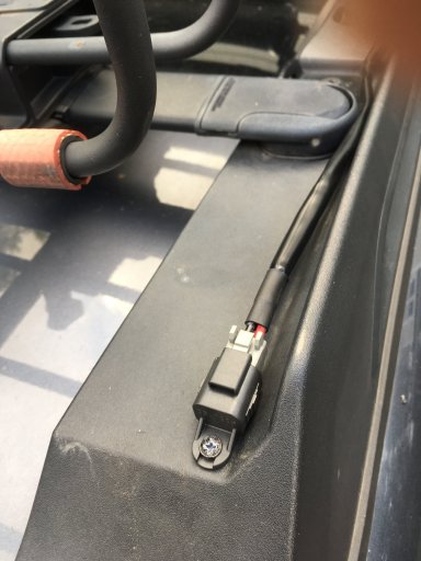

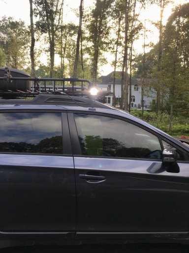

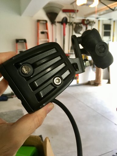

Got around to finishing my versatile roof lighting project. For lights I went back to Black Oak and picked up 2 of their scene light cubes. A couple parts from RAM and the mounts already pictured above means I can throw light wherever I need it. The scene lights are awesome for area lighting so whether I’m setting up camp at night or feel the need for more light on the trails this project ticks all the boxes.
My power point is docked out of sight in a water tight cap when not in use. With a Y splitter I’m able to run 1 or 2 lights depending on the situation.

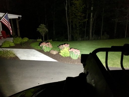

Light test. This is the only light used in the next picture.
I couldn’t be happier with the performance. They’re obviously bright but without any real hot spots. This is run through my Switch Pros panel which means I can turn these on and off outside the vehicle with my phone if I feel like it.

Thank you @Tinker and @martin_j001! I was originally going to go the traditional route but this way I only had to buy 2 lights, it only takes up 1 button on my panel, and I only had to run I pair of wires to the roof. I had no great desire to drill through the body and there’s a nice little channel on both sides of the windshield. My light bar is run up the other side exactly the same way and I think that’s as clean as that can be haha.
How / where is you wire going into the cabin area?
Since I run everything through a Switch Pros panel I just have that small harness cable run through the steering shaft grommet @Rocky. Everything gets buttoned up in the engine bay. Here’s a picture of the concealed panel after I mounted it.

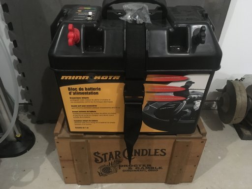

Finally decided and pulled the trigger on where my fridge will get it’s juice when parked. By no means elaborate. A simple power center battery box with integrated 12v sockets and easy to attach/detach terminals. Inside rests a fast charge 100AH agm deep cycle. This will be 100% stand alone, charged in the field by a Renogy solar suitcase and easily removed when it’s no longer needed to charge/maintain at home. I intend to run off the house battery while on the go and switch to Tesla’s boat anchor when parked.

Totally stole your RAM mount idea. I'm all for keeping things modular. It's working super well so far!View attachment 74106
No worries! I’m glad it’s working for you. I’m not one to hoard my ideas and I’m happy to see when they work for other people.
