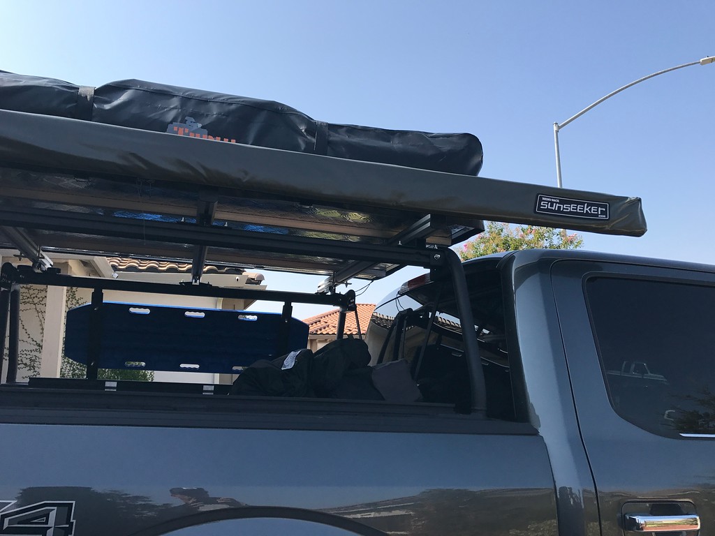

I have the Leitner rack also. I originally wanted a lower rack thinking I wanted to keep the RTT low but then realized I wouldn't be able to fit as much gear in the back and have worse access. Second, mounting an awning that low was an issue. I could still mount it but have much less headroom. Third, I discovered that my rack once assembled, could be dismounted in 3 pieces in less then 15 minutes and would only take me about 20 minutes to reinstall. So I just put it on for trips and my truck doesn't have to look like a contractor or landscaper.
Daryl 32
2,741
Corona, Ca
5546

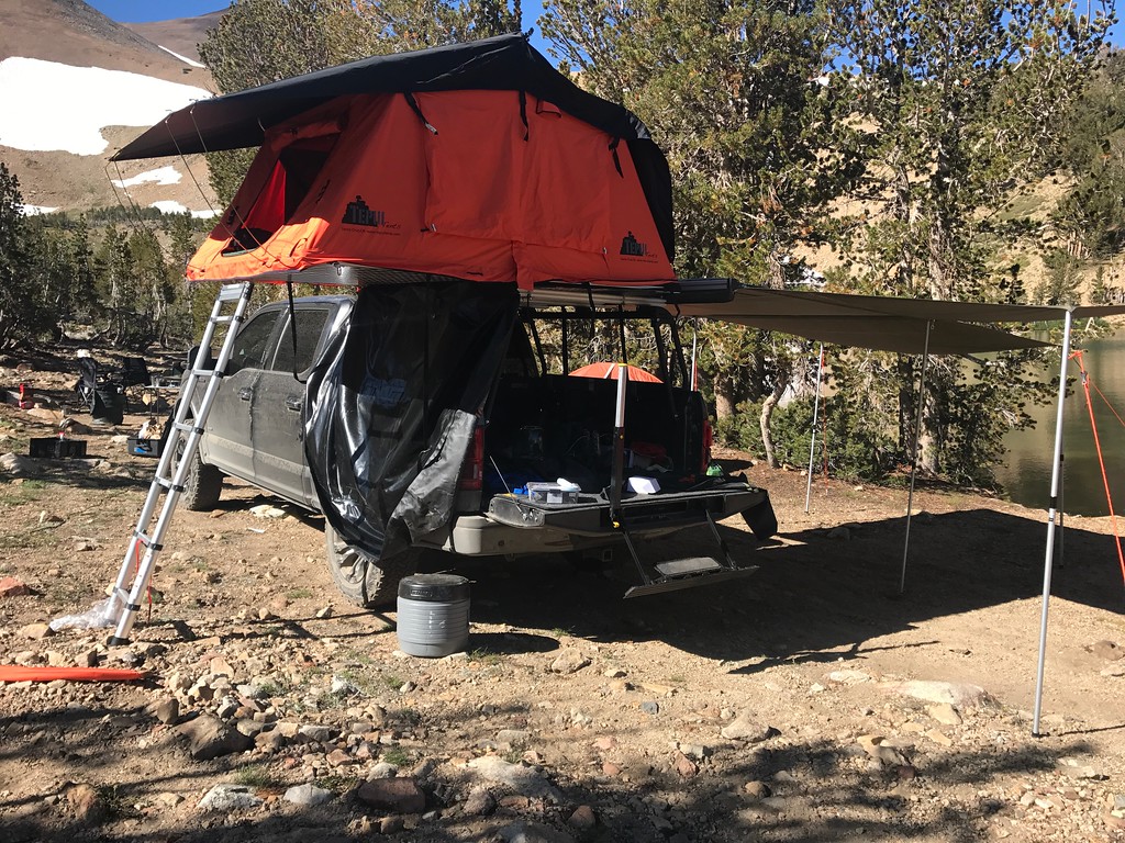

I agree with TDGarage on the awning thing, awnings are a great way to increase your usable shade and rain cover area around the rig. We currently have a 6" lift on our F250 with 33s, may change once we get the front 4x4 axle installed and get out using it.

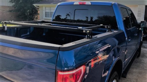

This is a terrible photo of what I built this weekend.
I found a YouTube video about it and bought the materials from Home Depot. It's using Grade 8 Bolts and Superstruts. To give it about 4" of lift from the bed, I bought some flat bar stock from Tractor supply and welded to superstrut right angle pieces. From there, it made footpads. I bolted them to the Superstruts and just used some cutoff pieces to tie the two bars together for racking strength.
Should be plenty strong. The C-channel and holes give you room to add attachments. I painted it black to just look nicer.
Bought some camper shell universal clamps to hold it down.
Cost around $120 including bolts and paint and clamps.

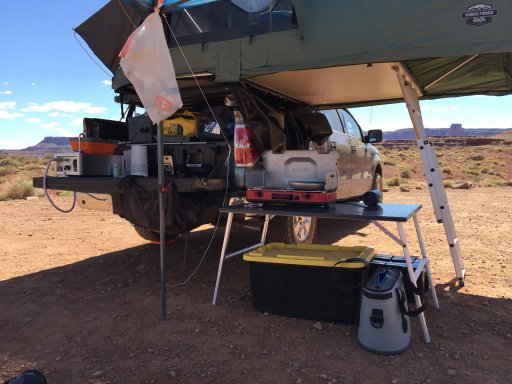

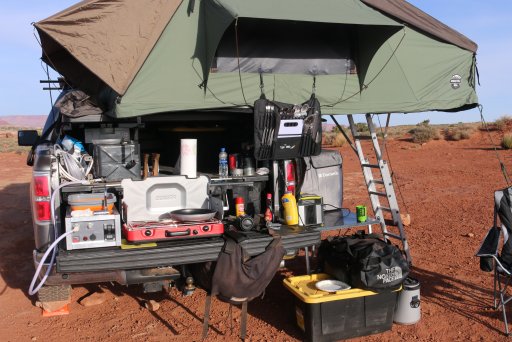

A few pics of my 2012 F150 Ecoboost, with FrontRunner rack and Decked drawer system. My bed space is just enough to get storage containers underneath while being totally safe when the bed is locked. It's virtually impossible to get into those storage bins. Just an FYI for y'all that are building out your beds.

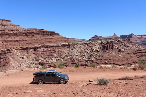

Hey Lee! Glad to help, and good timing since I just finished a trip from Nashville to Moab and was keeping track of all that. I can tell you I was super impressed with the capabilities of the F150. It climbed like a champ in 4Low up some pretty serious Utah mountains in Canyonlands - never slipped or slid, even fully loaded. Answers to your questions:
2. No lift, everything stock, and I like it that way since any lift would keep me from getting in my garage :-) The only thing I am seriously considering is upgrading my front coil overs and rear shocks. Planning on several trips out west and the rocky trails are pretty jarring. Would like a smoother ride.
3a. I've got stock 18" steel wheels with BF Goodrich T/A KO2 tires, which I absolutely love! Great on the road and the trail, without much noise. And, I inflate them to 40psi while on the road for better mileage.
3b. I've got the 3.5L Ecoboost engine and averaged about 17 mpg fully loaded (give or take 1 mpg depending on how fast I was going).
3c. This is a hard one, but my best guess would be around 400 to 450 lbs of gear, and that includes a 17 gallon water tank I put in the bed, attached to a TrailKitchens sink/filter/pump. The tent and rack are at least 250 lbs combined. That might be a bit underestimated, but not too far off.
View attachment 57514 View attachment 57515
Nice! I actually built a bed slide for my f150 using superstrut as the sliders, works great!
