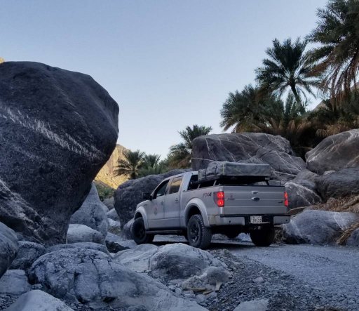

Do you have a pic of your truck?

Nice rig! I opted for 37s vs 35s for just a little extra clearance from the axels but the F150 is IFS so you can probably run 35s and still get solid clearance in the front.
35 on a F150 is as big as you want to go before regearing. On my old superduty I was running 37s easily because it was diesel like yours.....

I was thinking about a lower rack so the Roof Top Tent would be tucked in behind the cab.
You prob want something like my old setup....
This one is a front runner serup
This one is the front runner rack on some custom bars..
This one is a front runner setup

Raul I do like the rack you just showed me, especially how it is low behind the cab.
Why did you switch? Was there something about it yo didn't like?
Only reason I switched was because I also have the decked drawers and since that rack sat soo low I had a very small area to load up gear.
