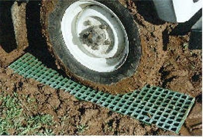

I assume you are talking about fiberglass "waffle boards"

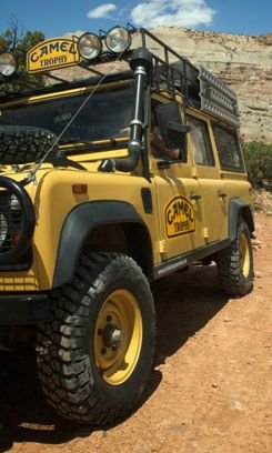

I looked into these a couple of years ago, due to the potential for effective bridging. I've seen lots of these bolted to Rovers from the other side of the pond. Less common here in the states.
My rig lacks a 2 speed transfer case and has limited ground clearance. A nice sturdy bridge would be very helpful for getting up small steps or across deep ruts.
There are some youtube vids showing these in use (I believe the folks at Overland Journal did a review of the waffle boards). They seem to work pretty well for bridging, but they make lots of cracking sounds under load. I don't know how long they would last before failing due to material fatigue.
The downsides (via feeble memory)-
They are fairly heavy (20 lbs/board). As they age, you can get glass splinters in your skin if you don't wear gloves. Some come with a heavy texture on one side, which should be good for tire traction, but a bit harsh on bare foot showering.
There are lots of holes (providing no flotation), so they can sink, depending on consistency of ground material. I don't recall if sinking in sand was an issue. Wet mud could be a problem for sinking. Sticky, firmer mud can fill all the holes and make removing the boards difficult. The mud makes the boards heavy, and clearing the mud out is difficult.
The boards do not have a ramp on the ends, so they have a tendency to flip up and smack the door sills when the tire grabs traction.
They are not inexpensive, at $268 shipped on ebay.
For me they are not the best solution for traction boards. They are long for storage. They will be difficult to get under my rig. There is the potential for sill damage if the board pops up.
For my small rig, the Traction Jack seems like a superior solution. Smaller size folded, no worries of sill damage, and far easier to get under my rig.
If the waffle boards were $99 for a set, I might pick some up, solely for bridging on specific trips. As it is, they are not the right solution for me.
Good luck

Thanks, this is what I was looking for. I agree that if I could find them for cheap, it would be a no brainer. But when they cost the same as Maxtrax, its hard to take the leap of faith. My rig is a bit top heavy and I want to reduce the articulation as much as possible, so the bridging factor is a big plus with these. However, with the reviews that I've seen with using Maxtrax for bridging, I'm still on the fence. I might just stick with the Maxsa's for now...

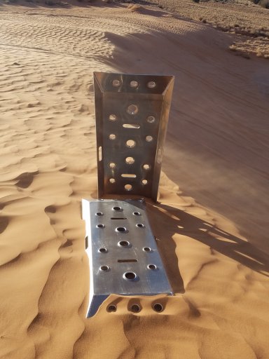

I just found this bridging board/sand ladder on ebay.
I have never seen these before and not aware of any reviews.
They are offered in several lengths (20"/$32), (32"/$40), (39.5"/$54) each/shipped.
I was unable to locate any weight or width specifications. They look a bit narrow to me.
This might be a viable/budget option for smaller/lightweight vehicles.
Cheers
************************************ (EDIT)
Found them on Amazon under the name CESS.
The 32" version has a shipping weight of 3 lbs, so I would assume they are constructed of aluminum. The shipping box lists as 32 x 10 x 6. I will then assume the width is about 10".
It says it can accommodate vehicles up to"3.5 tonnes". The spelling infers Metric Ton (2204 lbs) for a total vehicle weight of 8816 lbs. Not considering weight distribution of a vehicle, that comes to 2204/wheel. If US Ton: That is 7000 lbs. or 1750/wheel. It does not explicitly say if that is the limit for flat use, or bridging (unsupported).
There are 2 reviews listed. One was positive for snow, but has not tested bridging/mud/sand. The other review was not relevant to the function of the boards.

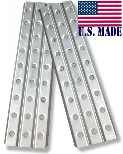

Anchor Mountain is stepping into the recovery/traction board market with our new Anchor Mats. We looked at the wide array of recovery tracks on the market and decided a better option was needed. We developed the Anchor Mats to be the best recovery track available today. The Anchor Mats are Stack-able, Durable, Bridge-able and American Made.This is Expedition Grade equipment.... they dont come in colors, they arent there for show.
MADE IN THE USA
All Aluminum, CNC bent, TIG Welded (No recycled milk jugs here)
Stackable.... Anchor Mats easily nest inside each other for easy transport and bridging.
Durable.... Spinning the tires will not destroy the traction on the mats.
Bridging Capable.... Double stacking the Anchor Mats makes them capable of bridging gaps and ledges in vehicles up to 5500lbs.
No obscure Mounting system. These will fit on a Rotopax dual mounting system. You can fit a Rotopax 4gal fuel tank and a pair of Anchor Mats OR 4 Anchor Mats on a single mount!!
SPECS:
47.5" x 17" (14" wide tread area)
14.5lbs each
https://anchormtnoverland.com/collec...mo-anchor-mats

Have these been tested in the snow?

These are the ones I really like. It looks like there is a newer updated version with teeth on the dimpled holes. The website says out of stock. Any idea if and when they will be back in stock?
