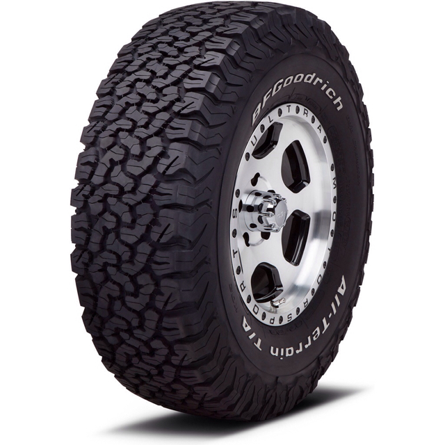

Just placed an order for a set of these BFGs in 225/70r16:
one size up from my current set, and the largest tire one can run on our wagons on a 16" wheel without supporting modifications to suspension in addition to the lift, or cutting the body.
Why did I get them? Curiosity and reputation more than anything. This has been THE go-to A/T tire for years, and never having given them a spin, I figured now was the time. I wanted something a bit more aggressive than the coopers, and I also wanted a snowflake rated tire which the coopers were not. Their performance in the snow was adequate, but not spectacular. Of course dedicated snows would be ideal; but I have head these BFGs are quite competent.
I have heard some concerns about declining quality, sidewall weakness, etc and will report on that as they wear...
