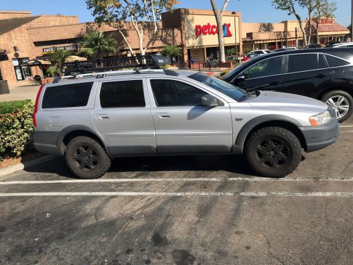

Hey Fellas,
I've been rocking my Satchel build (2006 XC70) for months now. I do not have the XC90 axles, so am I doomed? I've been getting a lot of nice comments and it's a fairly unique vehicle in my city.

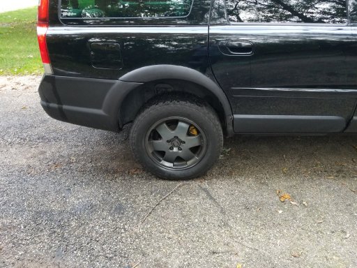

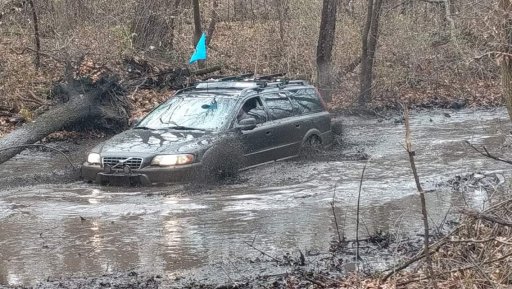

20191019_162243.jpg61935521_10217688567223467_6991633993934307328_o.jpg20191019_162250.jpgFB_IMG_1543106157243.jpg
I have played in a few mud holes with my 04. Has bad swede kit, 1/2 subframe spacers, performance exhaust, 1" wheel spacers, IPD strut mounts and skid plate, xc90 front axles and I'm sure other things I have forgot.
