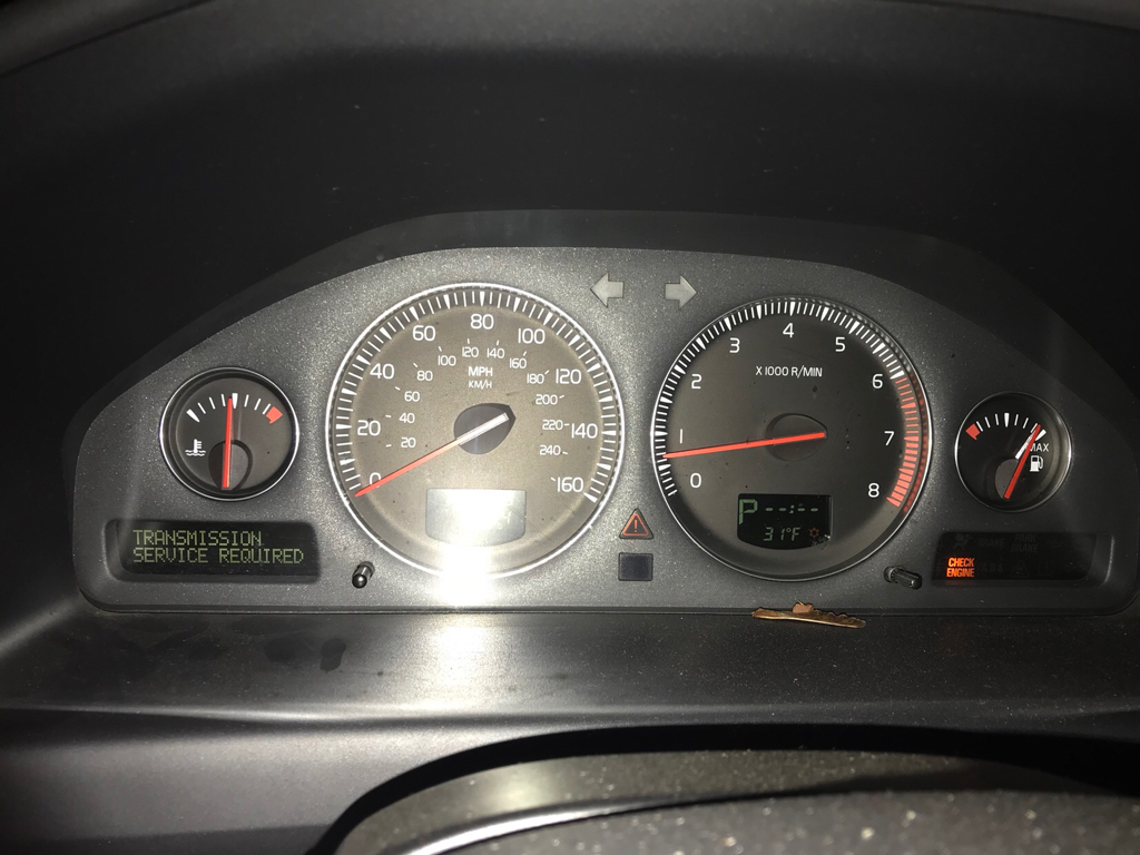

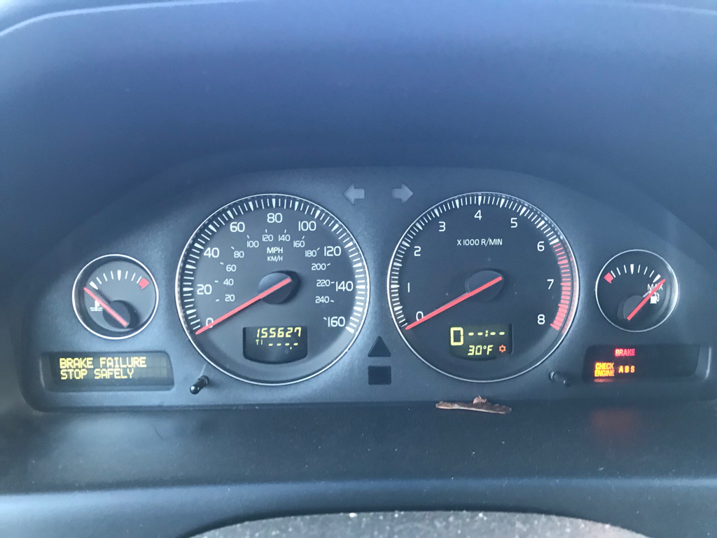

So THEN, after it came back from its trip to VA, I started throwing some ****y electrical tantrums. Was driving in the mountains and in the course of about 15 minutes the following happened:
- ABS Light
- BRAKE light
- Brake failure warning message
- Speedo died
- temp gauge die
- trip odo zeroed out
- “D” disappeared from DIM

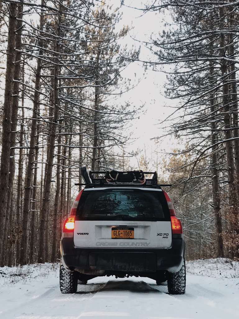

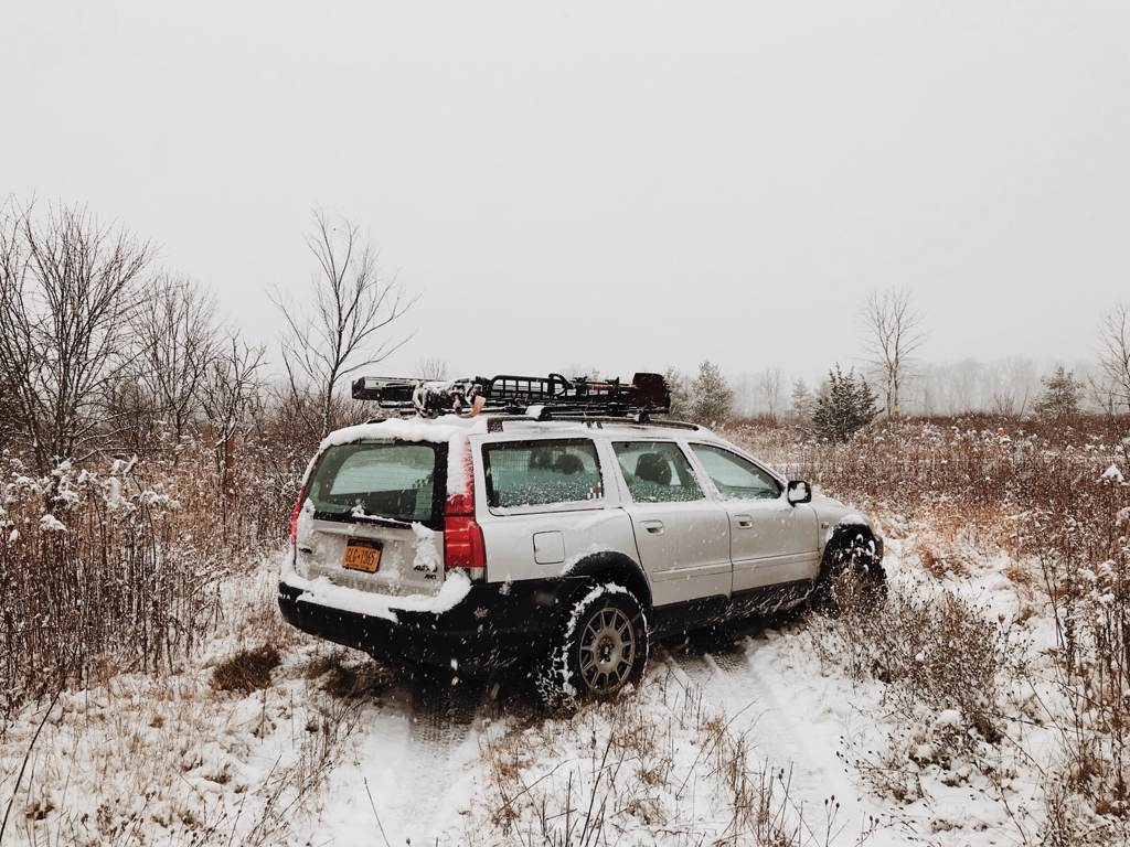

But absolutely nothing about the car’s performance was affected at all! So I drove it home (kinda liberating driving sans speedometer, gotta say [emoji23]) and parked it up. Consulting with my dudes led me to believe it was a BCM or ABS issue; likely a module failure. Googling revealed the same. So busy with a bunch of other ****, I left it to sit and drove the V60 for about a month.
This was fine, until last weekend when the snow came. I didn’t have the winters on the V60 (I KNOWWWWWW.....[emoji24]) and no time to put them on. So I decided to see what was up with the XC since it has the admirably-adequate-for-winter BFG KO2 treads on it.
Started it up and get an immediate “transmission service required” message. WTF?! So I let it warm while googling around. My dudes suggest a battery reset so I do that. ABS and BRAKE lights gone, but tranny warning persists. GAH. So I decide to take it for a drive. “It’s been parked on an incline in cold temps for almost 4 weeks, maybe it’s a fluid-read issue” I think to myself. So I take it out for a spin. 30 minutes or so. Stop here and there, Shut off and restart the engine 3-4 times, and boom...4th time its gone! DIM 100% clear and no symptoms of any sort while driving. It’s snowing and in fact, it’s handling like a ****ing champ in every sense.

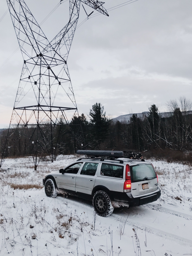

Park it up again and resolve to take it out once more that evening before loading the wild boyos into it the next day for an inaugural snow adventure. I do so, and put about 40 Miles on it in the snow that night. Roads are nicely covered and it’s a ****ing BLAST. I’m out drifting around with the heater up and a goofy ass grin on my face. And again, zero issues or warning lights of any sort *♂*♂*♂
So next day I take it out and we do this sort of stuff.....[emoji16][emoji16][emoji16]
We climb mountains, drift corners, kick up snow, yell, and generally jus slide around with gleeful smiles on our faces.

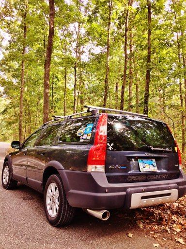

image1 (3).JPG I just wanted to say that I've been following this conversation thread for several weeks now and finally felt compelled to join OB because it's awesome to see such rare appreciation for the XC70 P2's. I own two of them currently, 2005 & 2007. I'm in the process of building my '07 XC into a multi-task vehicle: DD & Rally and the Yokohama GO15 AT's are being put on as I write this. I ordered the IPD skid plate yesterday but I haven't done too much else to the exterior yet. The bulk of the effort so far has been on the power plant and exhaust - went from stock 200HP to just under 350HP ; it now drives quick & tight after the build was completed. I've also installed performance grade stage 3 exhaust & downpipe, performance intercooler & raditor, direct dry intake (also being installed as I write this) IPD front & rear suspension replacement parts, body frame tie bars in the front & rear, and a Volvo roof rack set w/cargo basket. 302mm slotted & drilled rotors, pads and calipers on the front & rear are being installed now too. I'm still on the fence about buying and installing the P2 Lift Kit from the Bad Sweede because I'm thinking I could get the same just by installing XC90 P2 springs & struts.
Just thought I'd share this with you all and will shamelessly admit that I did copy you on the tires 215/70R16 for the stock wheels; I have a complete set of 17" Pegasus rims that I'm considering mounting some summer performance tires on since my '07 has got the speed. Still I'm torn between wanting to drive at 130mph + highway with wider performance tires or doing 60mph+ off road rally driving with larger & wider AT tires.
BTW...my '05 XC70 is completely dead as I jumped it a few years back and have held onto it since then for nostalgic reasons! I look forward to reading more about what you all are doing with your XC70's and maybe I'll even run into you all on the trails up in PA someday! Cheers - Chris

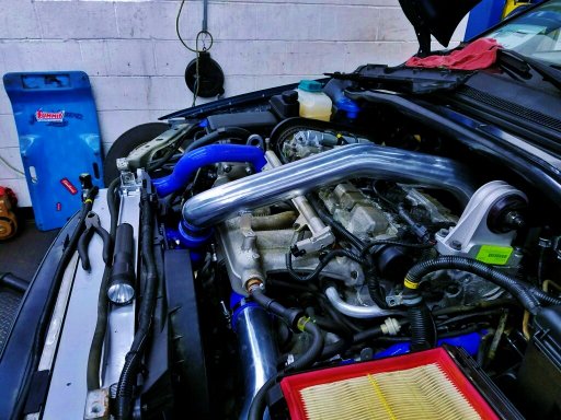

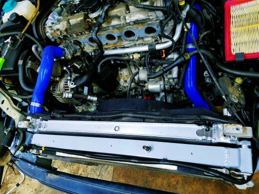

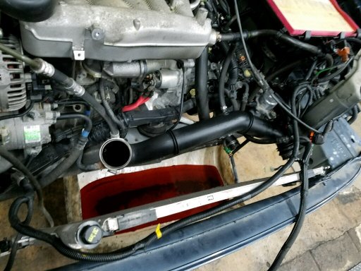

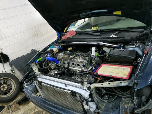

What tune and turbo did you go with?

I upgraded from the stock Mitsubishi TD04L-14T to a Garrett GT3582R with the ball bearing spool. The GT3582R is rated at a max of 640HP (paid roughly $1,500 for the unit alone) - this upgrade choice may seem a bit overkill at first but I'm hoping to do more all terrain rally driving where the additional power boost will be extremely helpful keeping the AWD moving forward on soft muddy ground. It was very difficult for my mechanic's to fit and install because the XC70 engine box is already so tight just with the factory stock. But when it was finally installed, on my first test drive the intercooler charge pipe blew out because of the power spike during the the initial turbo boost when I performed a speed acceleration from a standing start position. I have no desire to street race and hard acceleration from a standing start will destroy the AWD gears & rear-end but once I get the power output on plane then I can hang with the Tier 1's on open road. And I also had to upgrade the engine oil cooling unit as well to match the power generation. I haven't seen any major side effects on the engine temp so far to justify installing a H2O/Meth cooling kit. But I have noticed that the PCV system will need a mini-breather installed to discharge the excess heat.
