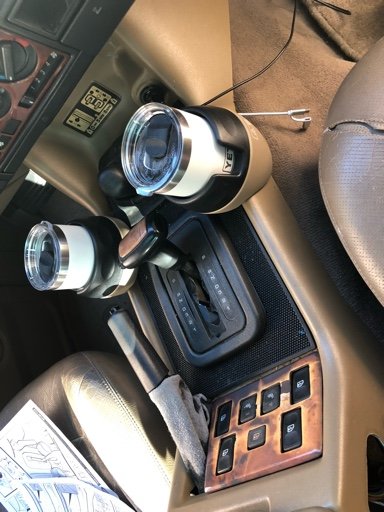

Today I rebled the brakes with my motive pressure bleeder and a scantool. Then discovered that the current pedal issue is not hydraulic. Narrowed down to runout, the internal failure of the master, or the booster. Gonna put it back up and check runout on all four this weekend.
In other news I fixed a major PS leak due to a loose hose clamp, picked up distilled water to mix up some fresh coolant, and picked up my cup holders.

Cup holders! [emoji482][emoji482][emoji482][emoji482]
It's the simplest things to impress a lr owner [emoji16]

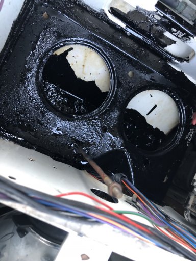

Today was a fun one! Started by dropping the “y” pipe and removing some broken studs, all but the last one which I soaked in Kroil and left for a bit. While I waited for that to soak I pulled the radiator hoses, heater hoses, and thermostat housing off. Then I cleaned, inspected, and tumbled the hose clamps before fitting new hoses and refilling with distilled water. I pulled the battery to find my first real rust, which I promptly wire brushed, and sealed with POR-15.
Found my exhaust leak!
Battery tray before
Battery tray after
And if you have the means and a Land Rover I highly recommend you pick up one of these. It’s a flexible 6mm driver which works great on Norma clamps often used on BMWs and Land Rovers.
Battery tray before
Battery tray after
On the battery tray, dont you know a litle dad ill do ya. I dont think you will have a rust problem there for awhile if ever again. Does that POR 15 have a rust inhibitor in it , or is it the junk that turns rust into steel again without even removing the rust ? Hey you missed the batter hold down bolt, your slipping bad !! LOL
It’s a moisture cured epoxy. It seals the corroded area from oxygen barring any further oxidizing(rusting). The hold down will get lanolin coated, the epoxy on the hold down would make it inoperable.
