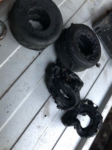

I did get the front shock bushings replaced, no clue whether these started out as soft as butyl or whether some chemical/heat exposure turned them that way.

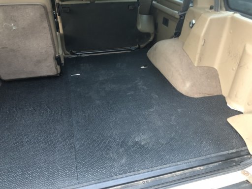

Was out today buying some feed, and noticed 1/2” rubber stall mats were on sale. . .
Having pulled the rotting soggy foam carpet under mat and factory carpet out of the back I wasn’t happy with the possibility of damaging the steel rear floorpan. I wasn’t enthused about rhino lining it as I have with previous trucks b/c it’s far cleaner and rust free than most. The rubber mats do a fine job of dampening the resonance of the large panel, while protecting it from the sorts of things I often toss in the back of my truck. And they are easy enough to remove for the occasional cleaning. Also they were budget friendly at around $75 for two of the mats and a blade for my vibratory tool to quickly cut them to shape.
