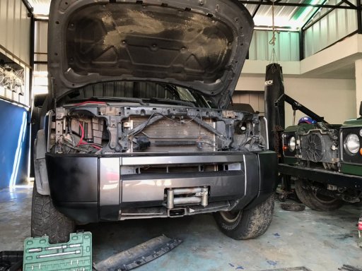

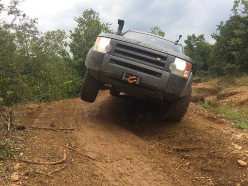

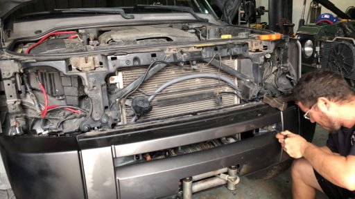

Edgar how do you like the coil conversion. We explored a little of Dominican Republic and it was beautiful. The suspension would be my fear on a island with very few parts available to fix it. Did you have the truck before the conversion?
Oh, I love the conversion, I did have the LR before the conversion, it did start to show some problems with the air bags, and I just decided to go straight to the coil over since the air bag suspension is much expensive here in the Dominican Republic, I honestly gotta say I was a bit skeptical with the conversion but once I installed it I fell in love with it.
Most part I get online from UK or US, the bad side is that I use a courier for the packages which charge by the weight, so heavy parts become a bit expensive, but so far so good, I got the HD suspension because I'm currently installing a winch on the front and a drawer system on the back.

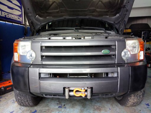

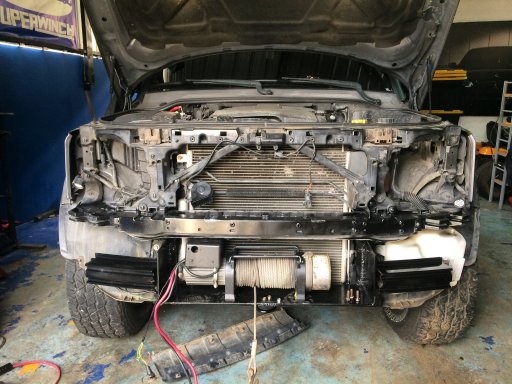

I would interested to know how it drives after you add the drawers and winch. How high does it sit? Similar to the off-road height?

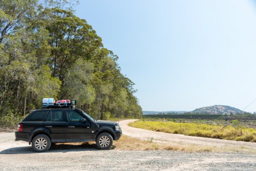

AndyH, how do you like the Sport? I often thought the sport would make a wonderful long range rig. It just handles so good on the road. How is it on the trail?
Just finished the winch instal and I'd say it drives better than before without the weight because of the HD Coilover suspension set up... The ride height it similar to the off-road setting, since I went with the 2" lift
Hi mate, love the sport. Great off road. On the trail the work really well. My mate with a patrol couldn't believe how well it went over some really rough bits of track on our last trip. Only downside is a bit less room inside for storage.
Sent from my E5823 using OB Talk mobile app

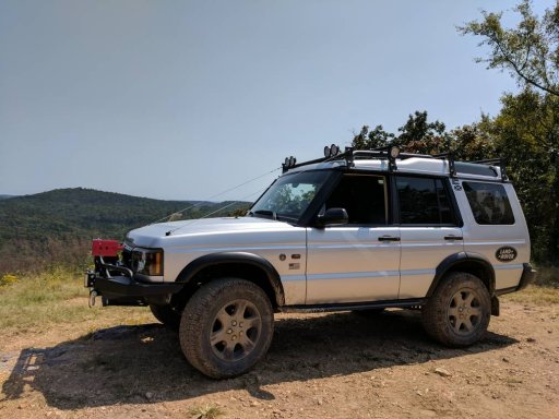

I have a Discovery related question: the stock “cabin air filter” for the Discovery is kind of a joke. It keeps bugs and rock out but when you are traveling down a dirt road behind a bunch of your best Overland Bound members the dust is choking. Last trip I placed a piece of open cell foam (not really filter foam) in that rectangular air intake opening on the passenger side. It didn’t help and I was thinking about oiling it or adapting a paper filter to fit that opening. I have looked on the usual Rover forums and have not seen anything that would do the trick. Anyone else seen a good idea to solve this problem? Thanks!
Mark D
3,250
Whittier CA
Mark
Dickens
2100
I would recommend trying the grey colored filter. It has carbon in it, and filters out more than the plain white kind. However, they are more expensive.
Sent from my Nexus 6 using OB Talk mobile app
This is the factory cabin air filter. It is just a small strip of foam that runs along the cowl.
