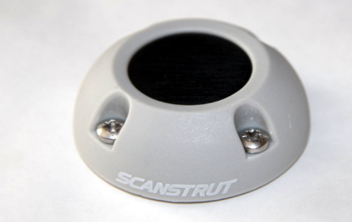

I used these to run cables on my defender for the Solar Panels and the CB Radio.
No issues with leaks at all so far and they have been well traveled in some extreme conditions.
ScanStrut Deck Seal DS40-P deck seal cable routing for antenna & nav light cables Waterproof IPX6 and IPX7

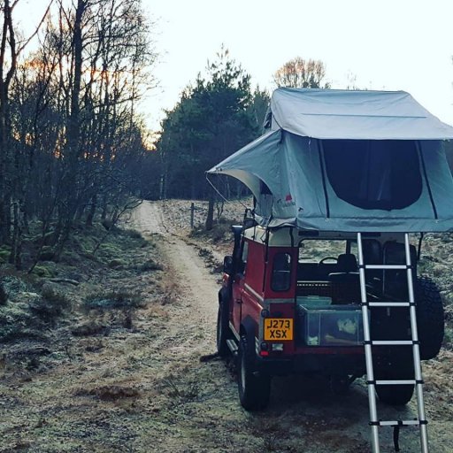

I've used 2 of these to run the cables for my "work" lights although the picture isn't clear.
Glad i jumped on this thred ive bought 3 of these Ill have to dig them out and use them
