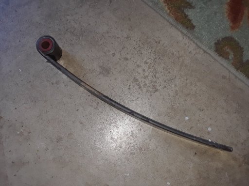

2. On the last day near the end of the off-pavement portion, one of my trailer's springs decided it had had enough and broke in half. Once it broke the tire was rubbing against the fender and helped trim a little of the fender off. So after removing the shock., we took a piece of fence post Ole was carrying and put it between the spring and frame and ratchet strapped them together (so now the axle was basically attached to the frame; no flexing at all on that side). Fortunately it broke on the back half of the spring. The other spring had flattened out and probably didn't have much life left in it either. So we put both trailer tires down to 10psi and carefully drove the rest of the route. Once on pavement, I aired the trailer tires up to 20psi, and drove it that way all the way home. I need to order springs, and will see about fabricating some bump stops so the springs don't overflex themselves.

Thanks for the kind words. It seemed like everyone played very nicely together on this trip. Yeah; somehow I did curse myself on this trip. I got a slow leak in a tire the second day (so I was running on my spare the rest of the trip), and the broken trailer leaf spring on the last day. Fortunately neither one kept me/us from finishing the WABDR, or from driving all the way back home. And it was a group effort fixing the trailer - it wasn't just me.
Les Schwab fixed the tire today. I guess it was a combination of dirt between the tire and rim (have no idea how that could have happened!), and a leaky valve stem. And new leaf springs, U-bolts, and spring shackle side-plates are on order (slightly heavier-duty springs in a four-leaf pack this time) for the trailer. Gotta get it all back together to lead the Old-School run up the WABDR in September (6-11 [maybe 12] Sep; check out the Rally Point for the Old-School run).
