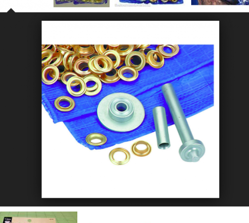

10) once your tarp is cut down to size you are gonna fold a 1.5" piece of the cut edge back onto the itself in order to make a double layerd edge or seam. Go ahead and put 5-6 grommets along this seam using your grommet installation kit from HF in order to restore original strength along the cut side of the tarp. This step is VERY important in making this awning reliable. ***If you don't reinforce the tarp you will constantly replace it due long tears along the cut edge.
Screen Shot 2017-04-23 at 1.09.26 AM.png Screen Shot 2017-04-23 at 1.09.39 AM.png

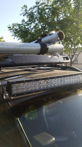

securing the awning onto your roof rack can be the tricky part, i used U bolts to secure the main conduit side onto my rack through some brackets i fabricated but I'm sure i could have done it without. I use the ozark trail buckle straps from amazon to keep the awning in a tight roll while driving. the straps are long so i actually run the strap all the way around the awning and through my rack for added security.
