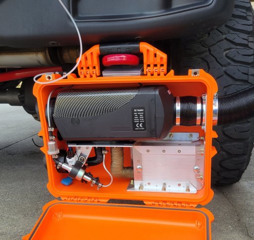

I recently built one of the Amazon diesel heaters and installed it into an apache 4800 case and I'm truly impressed with the heat output. Still figuring out all the settings.

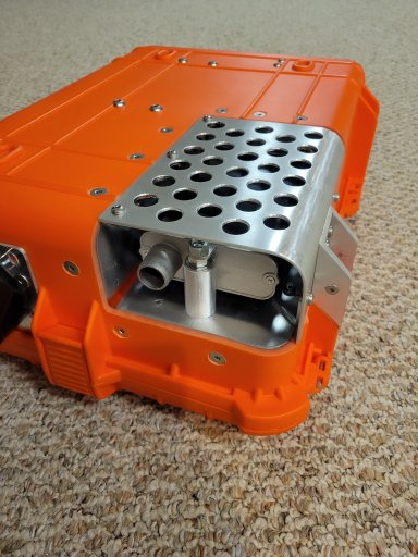

I thought I'd share my exhaust setup, I don't believe anybody has tried this. I installed one of the new muffler/silencers into the case and cut the backside of case out. I built an exhaust pan out of aluminum to incase it in and it worked out nicely and no heat issues at all.
Now to create some duct work in my rooftop tent.

That muffler cut out is great. An issue I've had with mine is a small breeze kept changing direction and blowing the exhaust back to my intake. I'm going to elevate the intake and put a small filter on it to keep powder dirt out.
