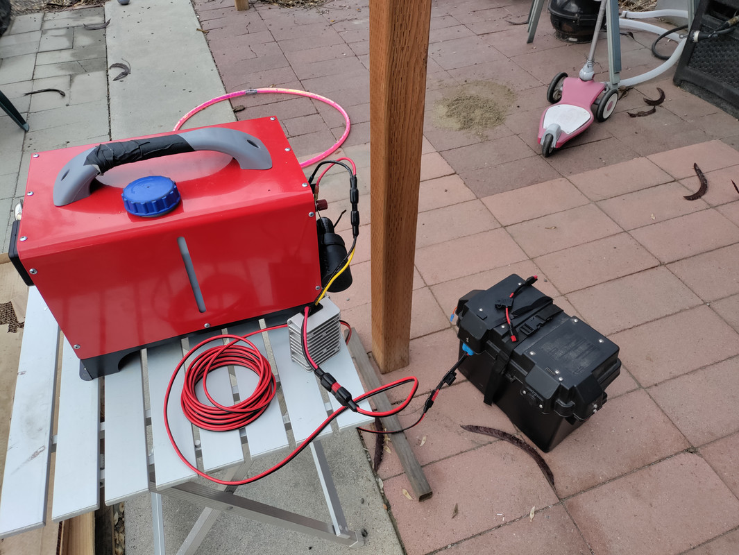

After doing some more research, I've learned that with the vevor heaters, error code e-2 is an over voltage error. This is likely due to a fully charged lifepo4 battery, with a working voltage of 13.3.
I've ordered a 12v 20A voltage stabilizer to try out. I'll update after it gets here.

Voltage stabilizer came in last night. Outputs a constant 12.39 volts when connected to the battery. I might just put some ring terminals on the stabilizer, and toss it onto the heater over the weekend, and try sleeping in the tent to see how it works.

This is what I bought. I hooked it to the battery, and put my multimeter on it. It's rated at 20A, but will only pull that while the glow plug is heating up, so it should be more than sufficient. I'll let you know how it works.

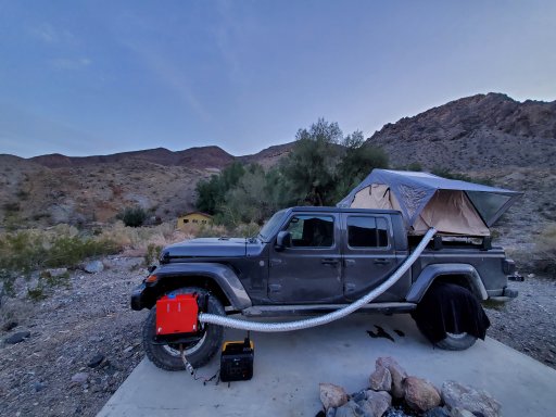

I bought my Vevor branded heater off ebay cheaper as well. Things I have learned it needs a good battery to start up and shut down when the glow plug is on other than that it draws 10 to 40 watts at different setting to run. It works so good at keeping me warm.

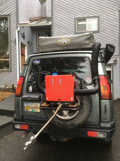

I have gone very basic as I only use the heater maybe 6-10 times a year, although it makes for a great tent dryer.
Protective cover is being built as the electronics are not waterproof, can also side mount if I am sleeping inside the truck.
Power is also very basic and admittedly inefficient, but it does work. The charger only pulls about 2 to 3 amps and as I only run the heater for maybe 90 minutes most days will bring it back up in about 4 hours.
Testing while driving shows no significant impact on truck charging. A dc to dc charger is under consideration once I find a decently priced 50AH battery.

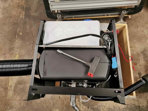

Hey guys, bought a vevor 5kw aio unit a while ago and been tinkering around with it since then, so far nothing catastrophic, worked out of the box, added some edge protection where the fuel line and cables crossed the housing and modified the exhaust, will add a inline fuel filter when I picked up some more flex hose.
It's running fine at home with a 12V 10A power supply.
If you are interested I can post some pics later?

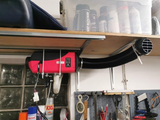

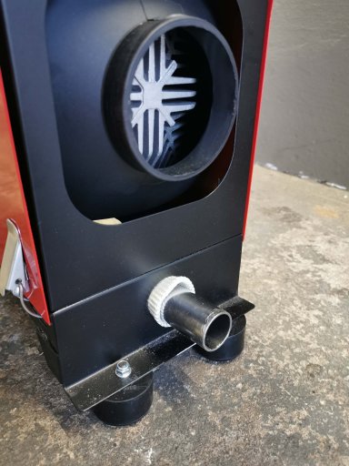

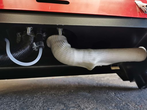

Second try...

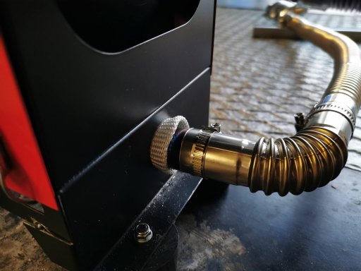

I'm dumping some pictures of the Vevor 5kw aio unit I have, with the finished "exhaust mod", exhaust was done with a 90° factory bend piece and a 25mm steel tube. I would recommend using 24mm tube or its imperial equivalent because the bend pieces fit over but not the regular exhaust tube. The isolation is a generic glassfiber isolation tube and it stays cool to the touch after 25 minutes running full power, I just flipped the ends in to have a clean end without fibers.
If you have any questions feel free to ask, will make some detail pictures when I eventually get back to work on it.
Currently missing but highly recommended is a fuel filter...

Testing out the heater with the voltage stabilizer placed inline today. Heater fired right up, and gave me no errors. Gonna run it until we have to leave at about 4:30, and see how it does.
Update: Heater is still blowing nice and hot, and hasn't skipped a beat. Going on 4 hours now.

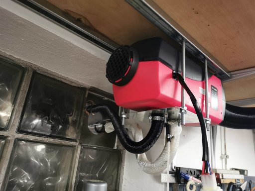

You definitely need to use a exhaust extension.

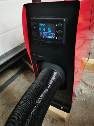

Got the second heater installed in the garage today, not finished but enough for testing and it ran great. And BTW it's also running with the 10 A power supply...
Got a 15A on order that will be boxed with some outlets so I can use it for whatever. IMG_20230128_184924_compress55.jpgIMG_20230128_200725_compress52.jpg

Looks good. Good idea and clean install. Thanks for sharing, Mathias!
And Iwould like to take this opportunity to say that this is an example of a great thread. Because here, in one thread, many members are gathering their knowledge, sharing it with each other, discussing it, writing down their experiences. This is how an enormous pool of experience and knowledge is gradually being created. and many people can learn from it. Simply great!
Let´s keep this going...

@MazeVX I know you have your exhaust routed, but out the side is better it as avoids both the cold air intake and hot air output for the hot air better. If you have a permanent mount then you can seal the exhaust better.
