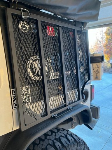

This is the one I'm thinking of getting. I bought a MaXpeedingRODS 5K heater off of ebay, but it received a safety recall so I had to return it. I was planning on building a case to enclose it. Now I'm thinking of getting the HCalory 5K heater in a toolbox diesel heater. I like the idea of having the tank separate from the heater for easier transportation and storage. Plus it's a well build box and still light weight. And it will sit well on my new fender table...This unit is pretty slick.....
