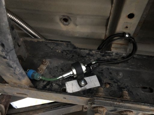

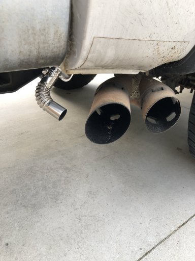

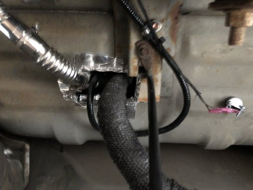

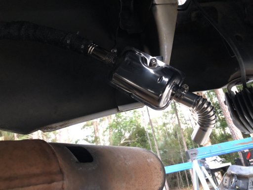

I just finished installing the Vevor 8kw heater in my truck. When I tested it, it was not as noisy as I was expecting. Since the fuel pump is mounted on the frame rail, it is hardly noticeable. If you want a video of the heater running, let me know.
Lets say that this heater is oversized for my needs. I ran it for an hour on high and it reached 112 degrees in the cap area. The exhaust did get hot but the wrap kept it relatively less hot. 150 degrees if memory serves me well. The fresh air hose that came with the unit is terrible. Paper wrapped foil. I replaced it with a 24" aluminum pipe. (Amazon.com)
Over all I learned that I should had gone with the 2kw :-( and the pump definitely needs to be at a slight angle to operate.

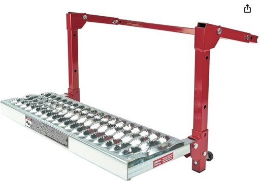

I saw this tire step in a video with the heater sitting on it so I bought it because its cool and has helped me work on my engine and bed area. Now I use it so often I couldn't imagine not having it.
