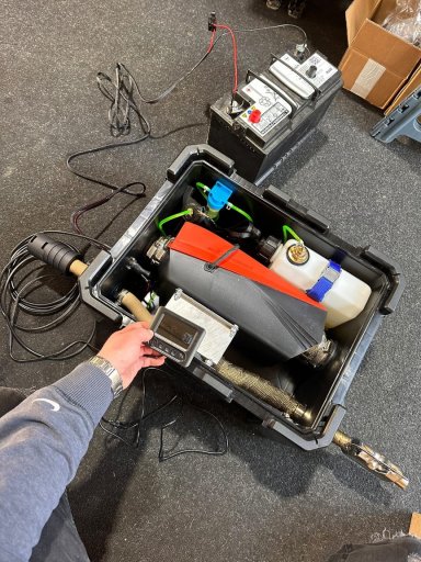

So, I hooked the heater up to the trailer, using the voltage stabilizer, while I worked on some other stuff. Had a 10A fuse on the fuse block.
Blew it instantly.
Replaced with a 15A fuse, and tried again.
Blew that one as well.
Put a 20A fuse in there....
Hit the power button on the remote, and watched the battery meter.
It was pulling close to 17A at power up.
But once it got going, I was seeing 1-2A.
I've also determined that the smell I'm getting is from the ducting. I'll need to get a new 4 layer duct.
Other than that, I'd say I got the bugs worked out. It's currently sitting in a 56qt plano bin in the trailer, as I can store everything inside that.

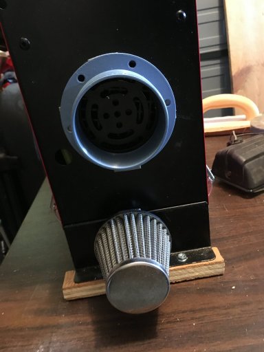

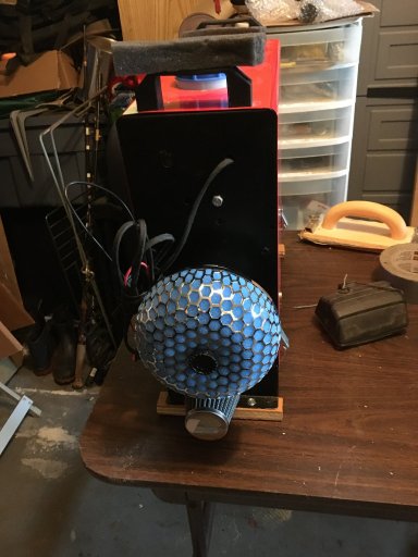

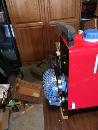

Just a few shots of my filter system. The blue is for the cold air intake to the heated air and the smaller one is for burner.
The flange for the larger filter is 3d printed and held on currently with hi strength double sided tape - until testing is complete. The intention is to add hose and run this intake above the heater, I can go to 3 inch aluminum flex hose to get the distance then a 3d printed coupler to add the filter.
The lower filter is attached to a 1 in copper coupler, with a bit duct tape to bulk it up and the hose is just pushed in and held in place tuck tape cover by aluminum duct tape. It is basically staying where it is.
The weatherproof cover is well under way, just figuring out whether to hinge doors for piping access or build external ports.

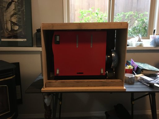

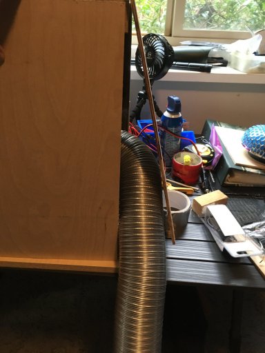

A little more progress on the travel case it is (in inches) 9.5W x 17.5 H x 22.5 long 1/4 in ply and 1x1 lower supports.
The big decision is top removal and load or side, I am leaning to top currently, but as I need more plywood I can think about more.
Side view with a temp rear panel and ends just placed to get a feel.
I thought about a pelican style case install, but the cases are stupid expensive up here, an Apache 3800 would run me 100.00 cdn, plywood is cheap.
The idea for the air intake is a hinged back panel, it will provide some weather protection while allowing for easy access to the connector

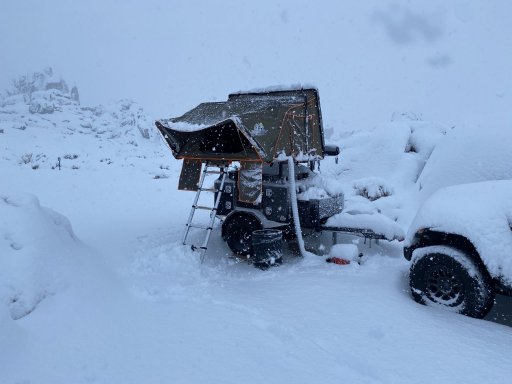

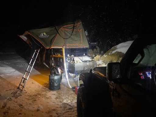

@surfnturf Just so I am clear (getting old) with heater on the ground and the LCD in the tent. The rest of the heater was good ?
surfnturf
1,116
Kings Mountain, CA, USA
11273

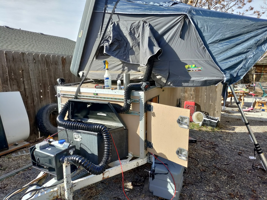

Of sorry about that... THE LCD is on the heater itself and seemIMG_3859.jpg to hold up to the weather just fine. The wireless remote is up in the tent with me. I used the remote to turn the heater on and off.... worked great. Full disclosure... I never sleep in a tent with the heater on. I only turn it when I'm awake.... once settled in for bed, I shut it off. In the morning, I click it on a few minutes before crawling out of the sleeping bag. Also, I left the heater on a lot while I was outside of the tent and used the tent to dry out wet cloths during the day or would climb in to warm up as needed. Here is another picture before the snow really dumped.
