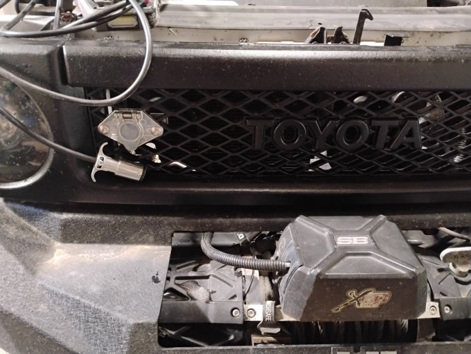

Finally got this mod to work.
The original winch controller plug broke all the pins because it got hopelessly stuck in the socket. Smittybilt uses a kind of 6 pin microphone connector, and they are notorious for sticking. Mine couldn't even be yanked out with pliers, so I had to wrench and twist it to finally break the pins and get it out.
I temporarily used a 4 pin flat trailer connector purely as a quick bandaid fix to get it working, but it was kludgy and ugly and not very strong/weather resistant.
I bought a 6 pin trailer connector and got it wired up into the freshly repainted grille:
Quite happy with this solution. It looks nice, easy to use and it's fairly rugged. Most importantly, my winch works properly!
