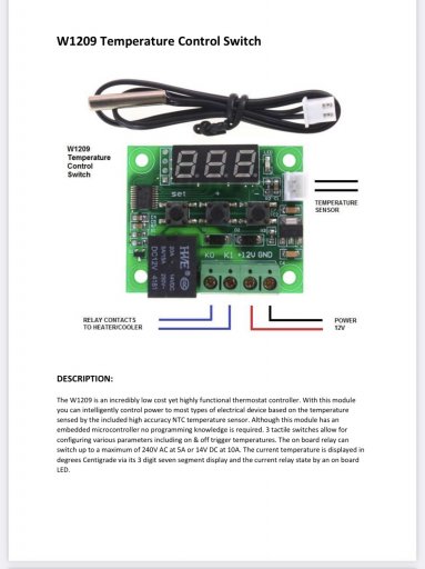

I ended up going with a 15 gallon polyethylene tank and am considering insulating it. I only plan to heat my water to 125F so it may not be necessary. My next decision is where to put the thermocouple. What was your thought process on putting the thermocouple on an inline section of copper pipe? Why not just put one in the tank? Do you happen to have a link to the one you used? How about your temperature display. How did you implement that? Link? The digital temperature gauges I'm finding are pretty bulky so it'll make mounting it on the dash a challenge.

page 1 and 4 of the blog has details and links to all components including the thermostat. The sensor itself has an extension wire and is attached to the copper pipe the comes out of the tank into the heat exchange as close as you can to the tank. It is attached to the copper pipe with marine grade heat shrink with adhesive inside. The less holes in the tank, the better.
The control unit is on the electrical panel next to a switch that turns the circulating pump. I circled it in red. It’s in a 3D printed box.
