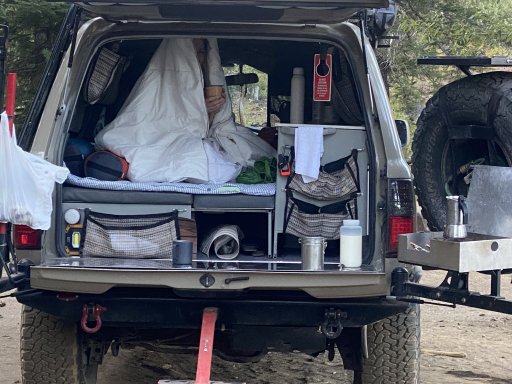

Just spent the weekend on the Cascades escaping the heat wave in CA. Every time we take it on a trip it reminds me how much I love driving this rig. We have full comfort of home. My wife looses the bags under the eyes because we sleep so well. It’s a state of mind as well as the air and nature around you.
Found an isolated lake, took a hot shower (air dry), dinner, enjoyed the full moon rise and went to bed.

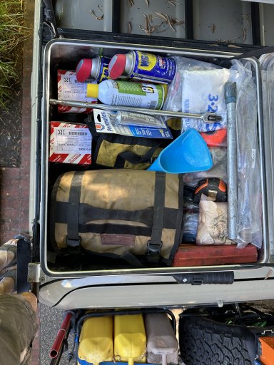

We are headed to a 5000 miles trip with 1/2 or more off road. You ask what tools/parts should I take. I think it really depends how you know your rig. We have done 80k miles in the last 4 years and the only break down was a sheared NEW clutch plate. I’m not taking a spare! I’m nervous because don’t know the root cause. But I’m keeping the ‘repair box’ as it was all the time excluding the welder because there is one already in the convoy.

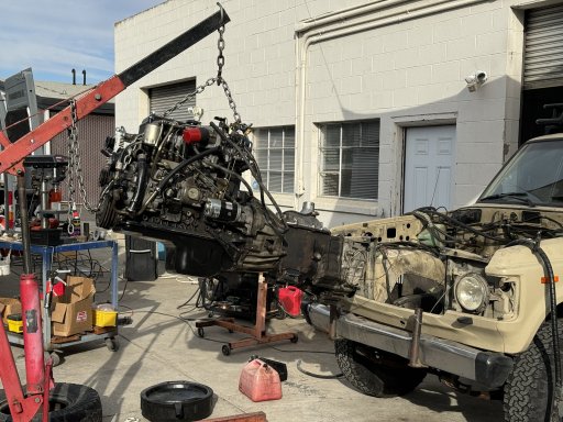

Meanwhile I swapped an engine in our daily driver, a 60 series landcruiser. Installed a 15BFT 16 valve 4.1L turbo diesel that came from a bus in Hong Kong. First trip up to the Sierras and back in a storm. It runs like a freight train. 26 mpg.
And... also been working on the troopy. Body shop has been putting hours. I'm prepping the frame for it.
