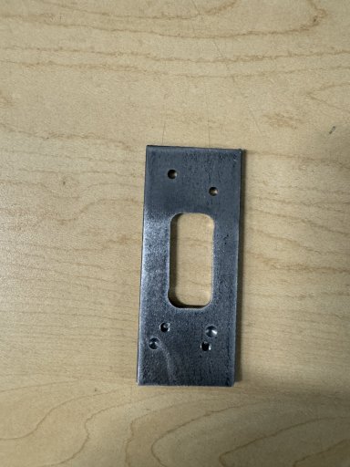

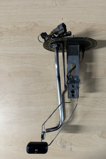

Finally got the 37 gallon tank. Took awhile to pull the stock tank off. Since the Long Range America (LRA) tank is deeper, installation instructions are to ‘butcher’ the sender unit wiring and arm and solder parts that they provide. I figured LRA should just provide a single bracket that locates the sender lower. I did machine such bracket and it makes the installation so much simpler.

This is the photo of the installation manual with the parts cut and soldered.
Machined bracket
New installation

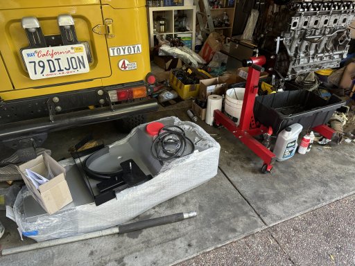

Upgrading the rig for a Long Range America (LRA) 37 gallon main tank. It will give us over 800 miles range. I will never fill diesel in CA.
not sure why Long Range America. it’s actually built in Australia.
Had to pull the hot water heat exchanger and modify the plumbing a bit. Waiting for hoses before final installation.
