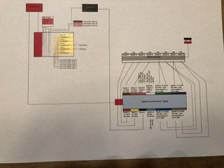

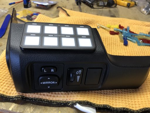

There’s nothing better than working on the car in the garage during a torrential downpour, so i unboxed the SwitchPros SP9100 to add to my electrical panel. I had previously installed a relay/fuse box on a PowerTray panel, but I wasn’t excited about adding a lot of dash switches in the few blank panels i had available and the SwitchPros 8 switch panel seemed like an elegant solution. The PowerTray will continue to power accessories that have their own on/off switch like CB, HAM and Compressor, but I’ll be adding more lights soon so needed something neat and tidy on the dash. SDHQ offers a laser cut dash panel for the left side of the steering wheel on the 4Runner, so that was the deciding factor to move forward.
Starting with the SDHQ Dash panel
I assembled the switch pros pad and trimmed a bit off the opening in the dash to accept the new panel. The instructions were very clear and the SDHQ panel fit like stock.

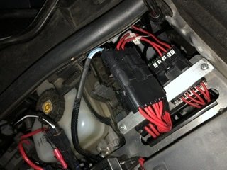

The previous panel installation included a 6x wiring harness through the firewall, so this accommodates the ignition and light trigger wires (blue and white) to bring them into the car to connect to circuits using two Add a Fuse connectors.
I velcroed a bus bar for the switch power connections to the top of the fuse box for lack of a better place to put it for now.
The Switch Pros panel is very easy to configure using the App, including changing the panel color to match the dash.
Here’s the wiring diagram. The only change I made was to wire the Ditch Light switch relay to a 20A pole (switch 1) instead of bypassing the relay off of a 35A pole. It’s a 45A relay, so I figured i still needed it.
it was a great afternoon project and wonderful to hear the rain pounding the roof while i worked. I hope everyone managed to stay dry or get really muddy!

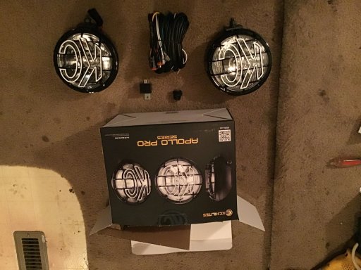

Wow what an expensive week for my Bronco, I spent over 600 in parts for my transmission swap (still have a few parts to order, and get the trans parts shipped), then today spent almost 500 on new lights and parts to make an old school light bar. image.jpg
I still have 2 KC Apollo Pro spot lights coming, and the mounting feet for my DIY light bar.
