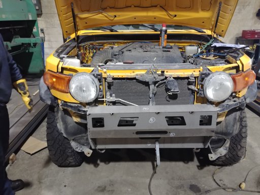

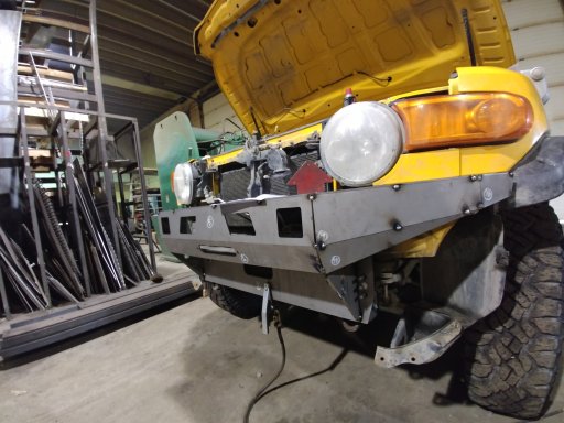

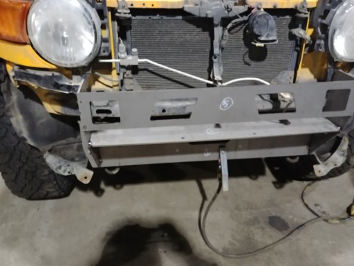

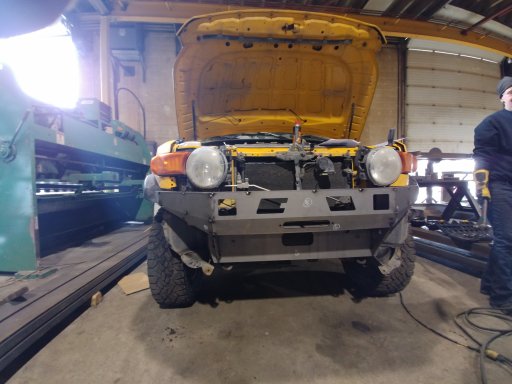

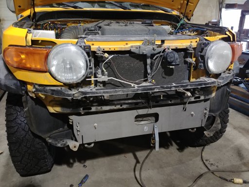

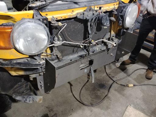

Here are a few more pics of mu coastal offroad bumper build. The bumper comes flat in a box.
After the stock bumper is gone, the mounting plate gets bolted on the stock location
Next is the 2 side plates in factory holes. Bolt to the frame then tack.
The winch mount plate goes inand rests on a nice spot. No winch yet. Maybe later. Then the front plate. Fog lights ready. I had a set and he custom cut the holez my size.
The front fairlead piece. The mid part is done.
The wings are 4 or 5 pieces each. One side done.
And the other side.
That is as far as i got this day. Shell of the old bumper put back on with a few clips and a prayer until next time.
There is a front plate that goes on after some beads are layed. Then more beads and grinding and flapping.
More updates as the progress progresses.
And the other side.
Thank you for the pics! This gives me a better idea of the process.
