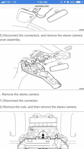

That is fantastic. How was the install? Is there a lot of shenanigans under the housing panels? ive wondered what is under the eyesight covers for this same purpose. great work!
It actually wasn’t too bad. There are two bolts under a cover. Once you remove those there are just the standard clips all around it. The eyesight camera system is independent of the rest but there is a bunch of connectors.
There is probably a good 1/2” to 3/4” inch of space behind where I put mine.

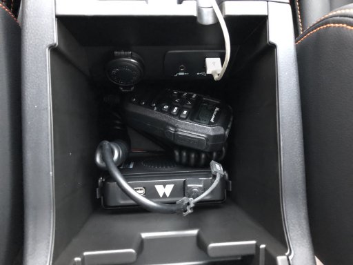

That is awesome! I'm not confident enough in my skill set to touch anything anywhere near the Eyesight stuff. I wired all my lights to a control box under the hood that is controlled by a wireless remote. I got it here, on Amazon. The cool thing about the remote is that I was able to program it to the HomeLink buttons on the bottom of the rear view mirror for the ones I use regularly. The first one turns on the four forward facing top mounted lights (my critter spotters when I'm driving into the holler where I live), the second one turns on two rack-mounted rear facing flood lights for backing the trailer up and loading/unloading the boat, and the third one turns off all the accessory lights.
The remote is handy, but most of the time I keep it stored in the console. It looks like this:
98564
It can control up to 8 lights.
(2) max 240w, (2) max 60w, (2) max 42w, (2) max 18w.
I have five of them set up.
Button #1: two rally lights on the bull bar
Button #2: four rally lights on the front of the roof basket
Button #3: port side flood light (basket mounted)
Button #4: starboard side flood light (basket mounted)
Button #5: two rear flood lights (basket mounted)

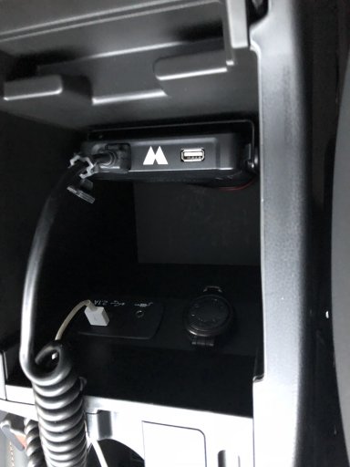

That was my plan as well right now my GMRS is hooked to the wires feeding the accessory plug into the glove box as that is where my radio is. But I know that isn’t the best place to source power or a clean ground from it was more so to get me up and running for next weekends trip. I’m actually installing a 6db gain antenna this weekend as the one that came with it seems to not have the greatest range.

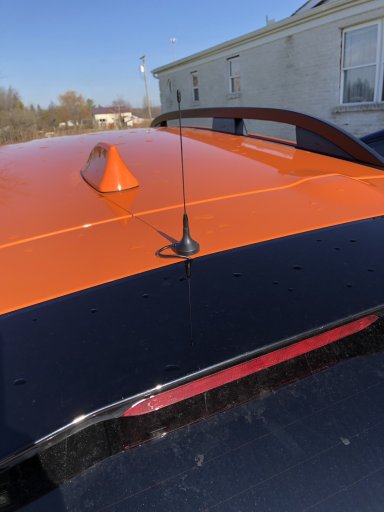

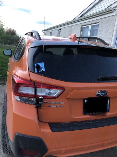

Here’s some photos of the GMRS if anyone is interested in how I mounted it.
Midland MXT275
Current antenna
New antenna

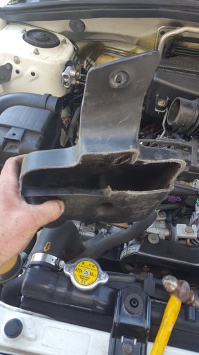

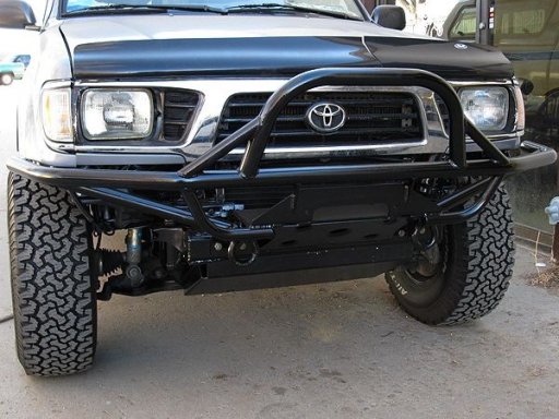

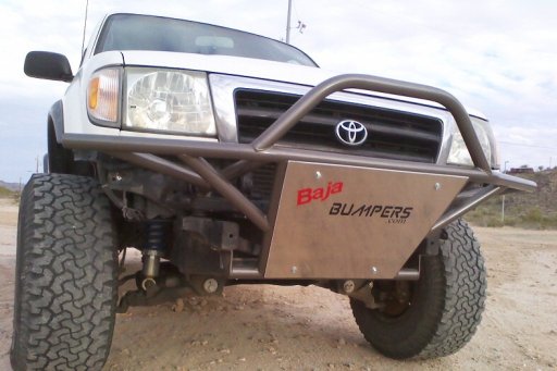

So I’m getting a tube bumper built this week similar to a prerunner style (see Toyota picture)
And I’m going to be cutting my bumper just a bit more to fit it better. I saw this plastic piece (see picture) that seems to be blocking the air intake piece. Seems like it’s blocking airflow. Anyone know if there would be an issue in me removing it?
Also I put fender flares on a bit ago but one of my issues with the shaping is, it has to bolt into the bumper to look “normal” I think. But I want to put a rubber gasket on with 3m tape which would mean I’d have to replace it every time I took off the bumper cover. Which I obviously don’t want to do. Any suggestions? See pics

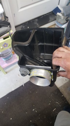

With future plans of putting a snorkel on i found one of these maf plates for putting on a cone filter laying in a cabnet in the garage and there just so happens to be a hole in the fender in the exact spot the plate would fit .For the time being i also opened up the stock intake port to hopefully let a little more air in . 20190529_150516.jpg20190529_153441.jpg
Looks intentional to help prevent water from getting forced into the air box.
Reactions: Logan Hall
Logan Hall
I think you’re right on the water prevention. Definitely gonna need that till I build a snorkel lol.
