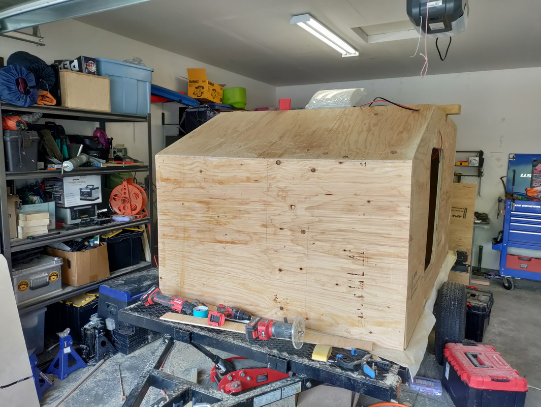

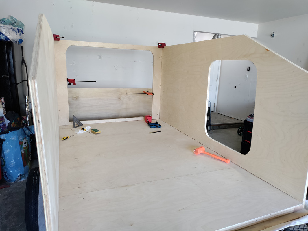

Had another great day working on the trailer today. Got the floor fully pmf'd, and flipped back over!
Using Pl premium adhesive, we attached the walls at the base, and screwed them into the 2x4s along the edge of the floor.

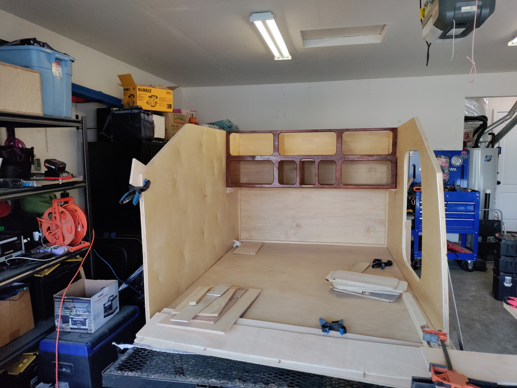

Got the interior rear shelves built and glued yesterday.
I still need to stain the front piece, and cut out the openings though.
I also got all the interior wall skins poly coated.
By the end of today, the galley should be fully assembled.

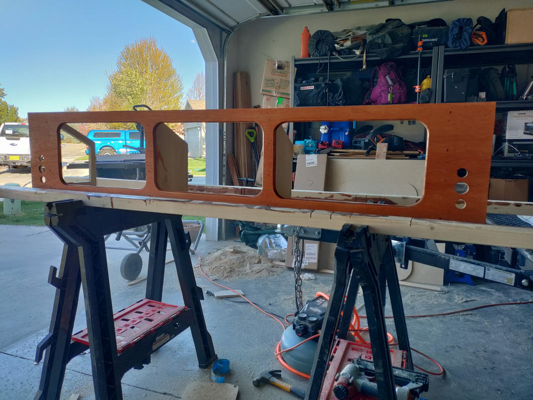

Got the front of the main interior storage stained:
After putting on a second coat of stain, we then glued and pin nailed it to the front of the main storage. After it dried, we managed to slide it onto the supports:

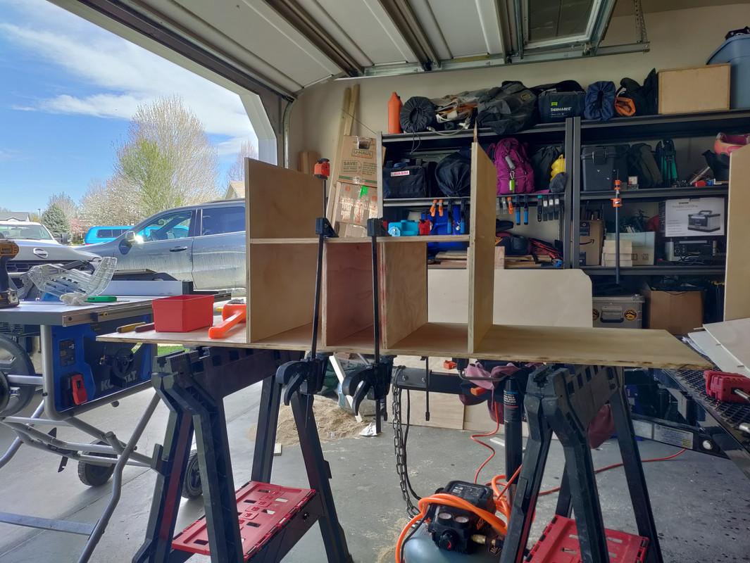

We the focused on building the rear galley cabinets.
I forgot to take pictures of the counter supports, but cutting voids out, allowing for me to get my arm in there to run wires and water lines, leaves them weighing only a couple of lbs, at most.
We put those in, making sure we had room to clear the door frame, and glued and screwed them to the floor.
We the put the counter top on, and started working on the upper cabinets.
Got them cut, routed, glued and stapled, and set in place, prior to staining.
Very happy with them!

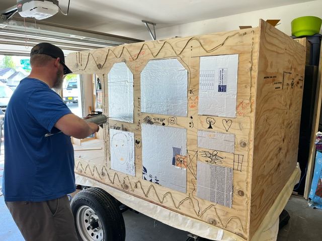

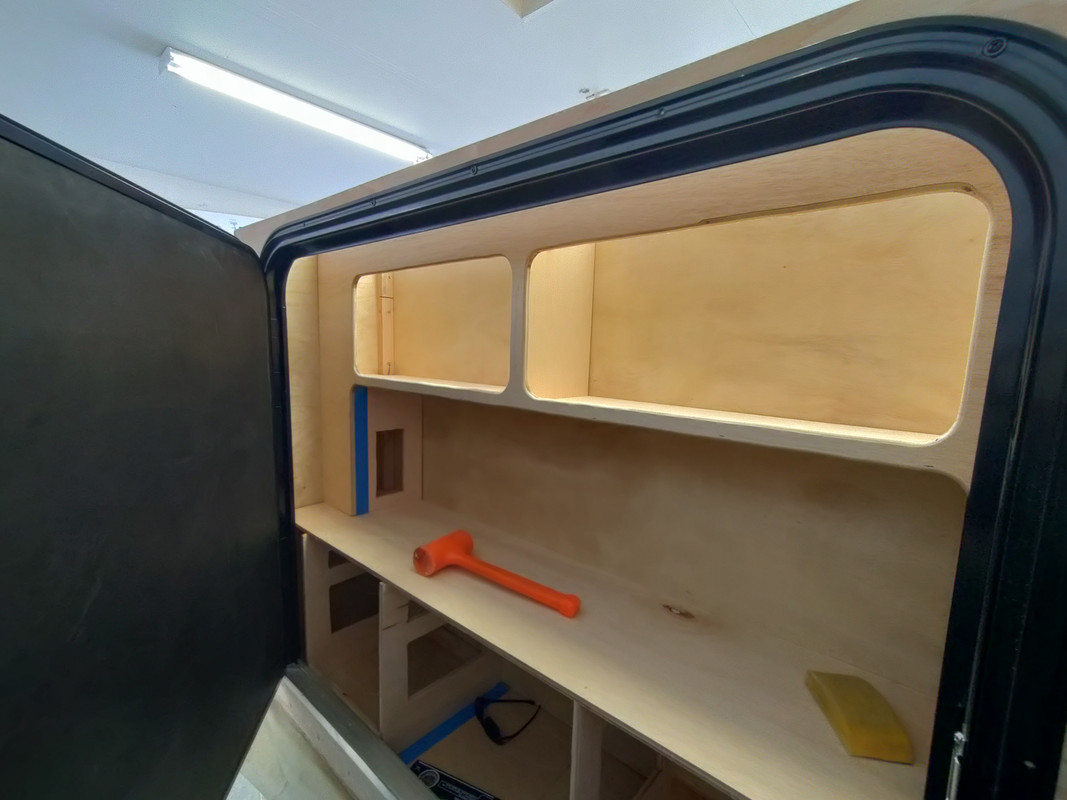

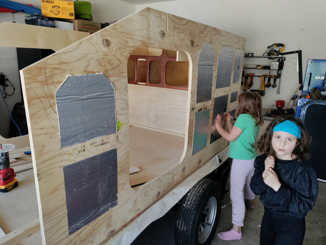

Got a whole bunch of small stuff knocked out that needed to be done before we put the outer side skins on today, as well as the headliner skins.
Galley is stained, and temporary switch plate is in.
These four switches control the water pump, tank anti freeze mat, overhead lights, and part lights.
Dave got all the insulation cut for the sidewalls while I was working on the galley.
We also let the girls draw all over the side of the skeletons. Nobody will ever see it, but they loved it, and we all know it's there.

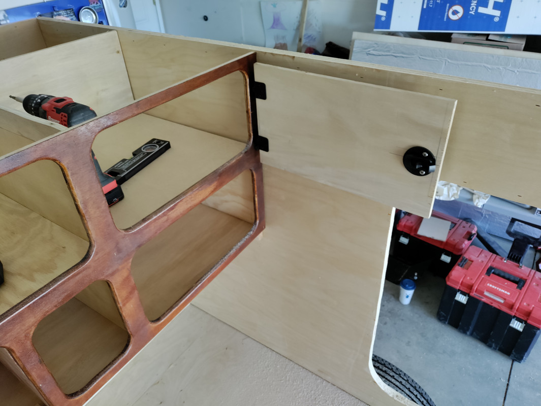

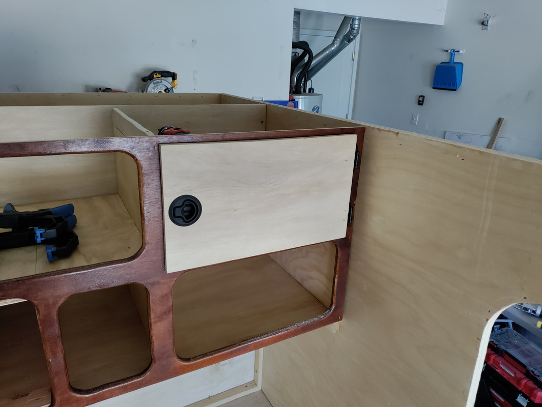

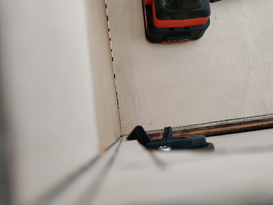

I then proceeded to start working on figuring out how the latches were going to work on the cabinet doors.
The latches have just enough room to catch, and keep the doors from opening.
I guess I can order the other 4 now.
I still need to pull the door off, and decide if I want to stain it, or keep it naturally colored. And round the corners, but I now have a template for the other 3 doors.

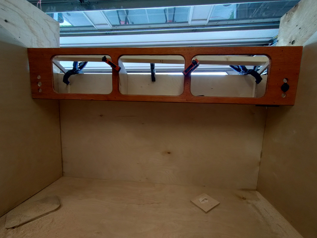

The last thing we did was worked on the front overhead storage.
Got the face stained earlier in the day, and got it all assembled.

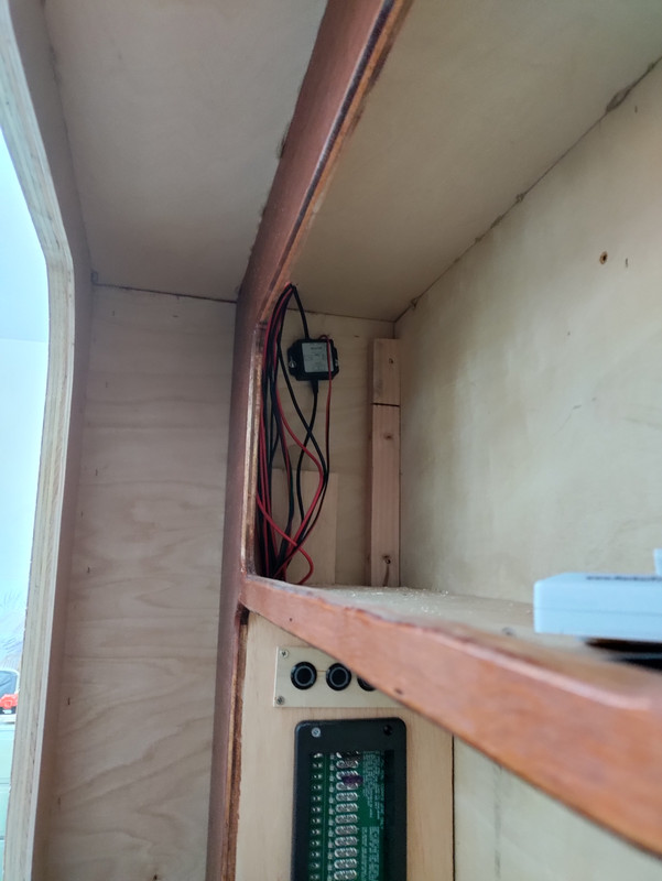

You can see a void in the skeleton on the left side... This is mirrored on the right side. These will get aluminum panels that house a 12v socket on each side. This will allow us to plug in the cpaps, and leave them up there. That way we don't have to pack theme up everytime we move.
The holes on the front are for switches and usb charger outlets.

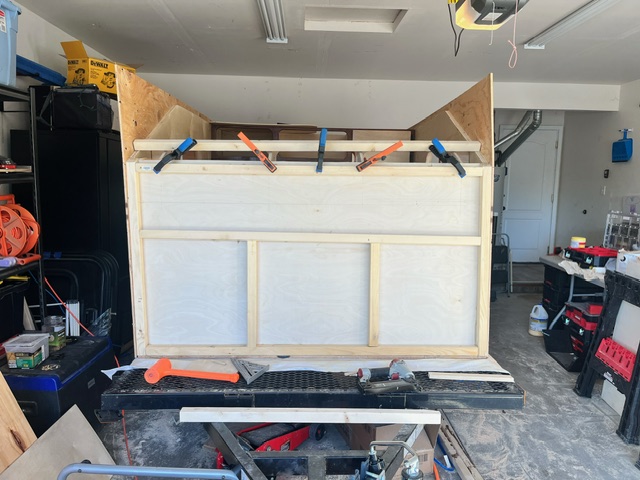

So, update from sunday. Throughout this whole process, we've been dealing with warped 3/4 ply for the skeletons. Spent much of sunday morning building a frame for the front spars that would be used to basically pull the whole front to be more straight.
We went through a whole 28oz tube of PL Premium adhesive gluing on the side walls, front interior wall, and framework
We also slid the front interior skin in, and got the front storage glued and clamped into place.
We should be able to permanently attach the rear cabin storage, and galley cabinets next weekend, as well as finish up the interior roof panels and spars. Then we start running all the wires...

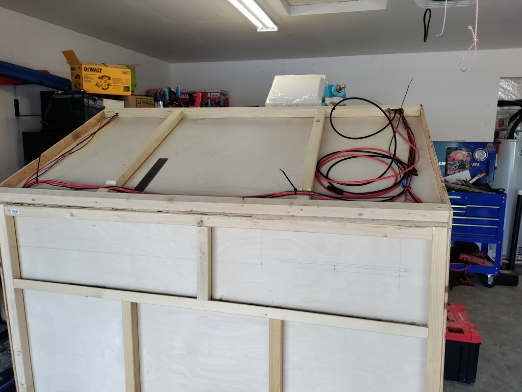

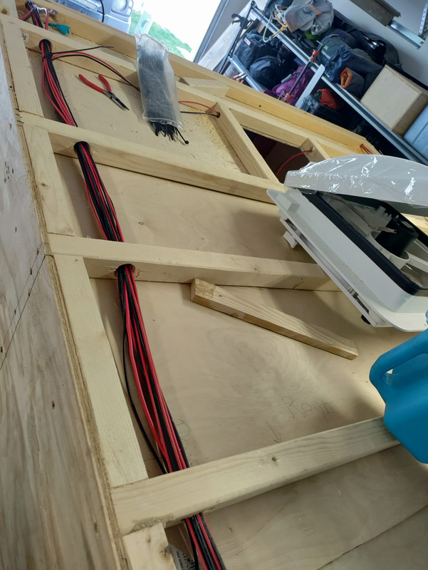

Big progress this weekend. I took Friday and today off, and we managed to get LOTS done.

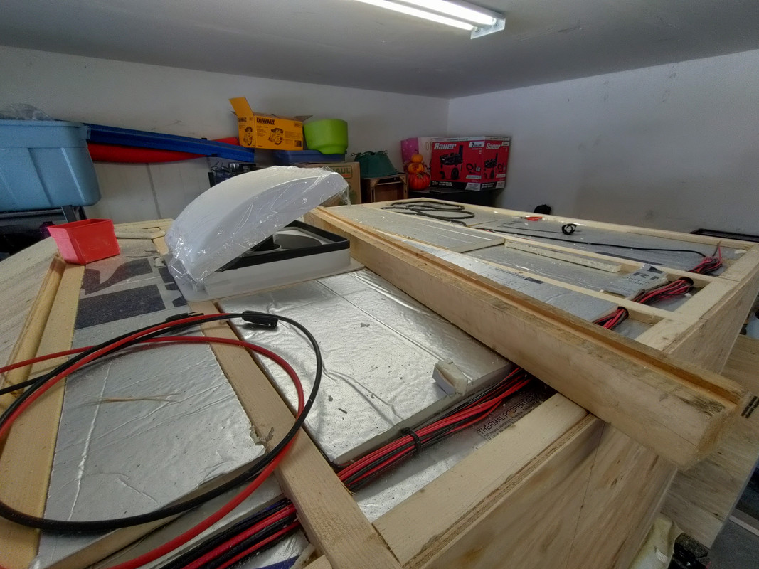

First thing we did was run all the wires for the cabin through the roof.
Got all the insulation in. We had a full sheet of r5.8 3/4 Inch insulation left after doinf the sidewalls. We decided to use the whole thing, and double layer it on the roof.

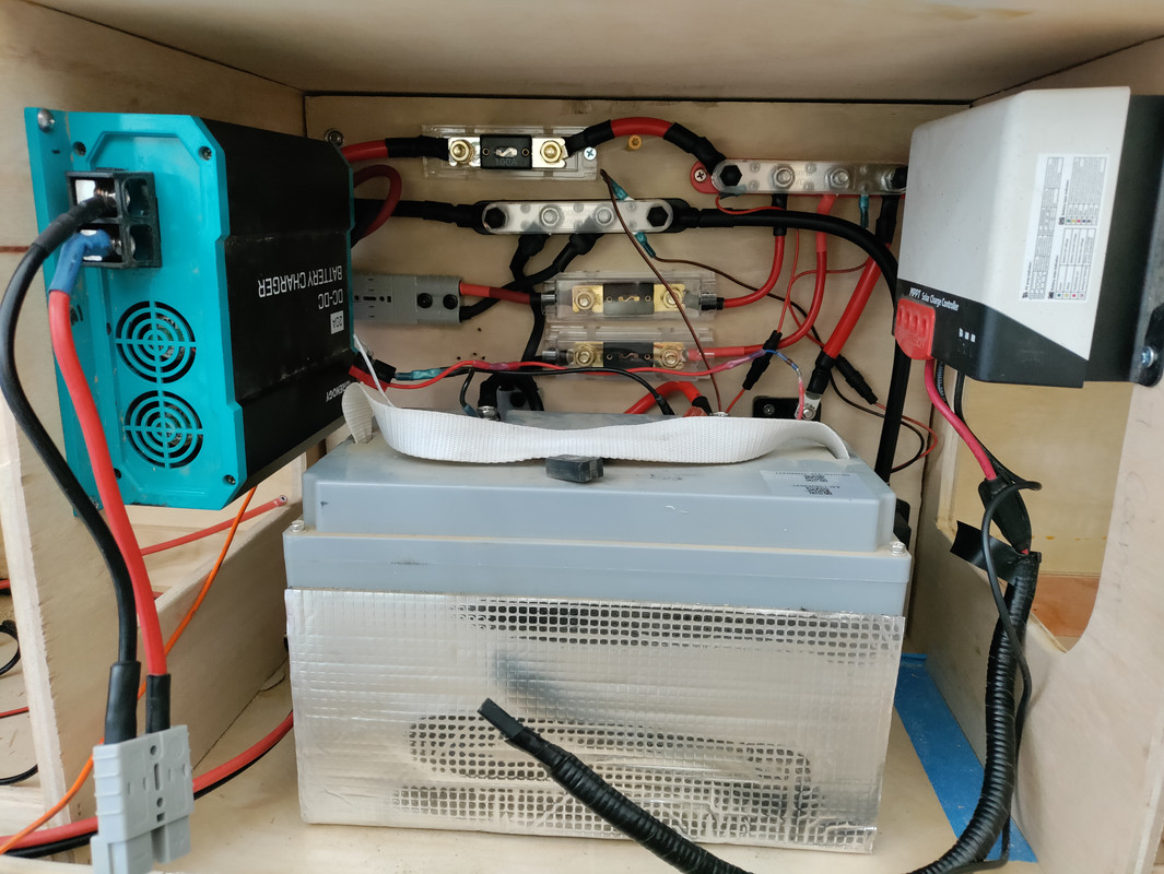

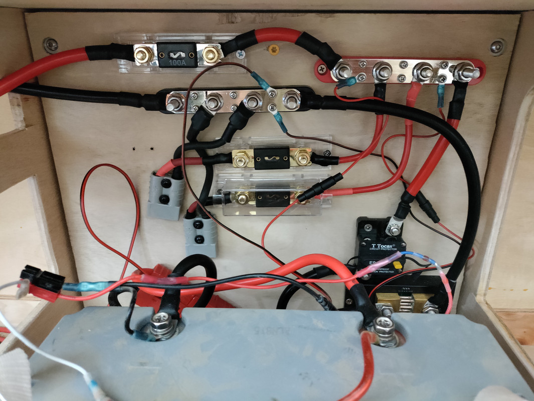

I then got to work moving all of my electrical components into the battery compartment. I need to make a longer connector that goes to the distribution panel, but for now, it's just running through the drawer skeleton.
I then decided to test the cabin electrical and get it ready, so that hooking everything up was easy.
Today, I put connectors on the wires for the fan and light, made sure the cabin switches were good to go, then got to work putting the outer skins on the front of the trailer.
Just two more pieces of plywood to put on, and then I can start the pmf process! (canvas will be here tomorrow).
Reactions: WYWander

Looking good. Nice wiring job.
Thanks Larry! I ended up running more ground wires to the front of the cabin than I needed, do I have a spare or two, in case anything happens.
There's also two power wires that run into the rear cabin cabinets. These will power a 12v multi usb charger that will power a TV, media player, and Bluetooth speaker (eventually).
There's also three more small wires that will connect to the controller for the diesel heater, when I get it.

Very nice Reaver!
I intend on running a ground buss down the length of my trailer and splicing grounds in wherever needed with soldered joints. But maybe that's more work than it's worth... My prior build had individual ground wires for each thing and it just seemed like way too many wires at the time.

Very nice Reaver!
Personally, I don't like relying on grounding via the frame, if that's what you're referring too. If you talking about running a wire, and splicing into that for grounds, I could see that being advantageous. In my case, I have no wires down low, so that would be out of the question. I will be running the wires powering the DC-DC charger underneath the trailer, but I don't want to ground to those, as those are connector to the tow vehicle battery.
I have a ground circuit for the switches on each side, and a separate ground for the charging and accessory ports. I had plenty of room for the wires, so its not a huge deal to me.
Nope, not a fan of frame grounding either. I'm going to run the buss up top, along with the power wires. The splice is a section cut out of the buss wire (much larger gauge,) the buss wires pulled apart at the center, the incoming wire fed through that hole, wrapped around and soldered, and then a cold shrink wrap around that. Might be overkill but considering this is "expedition" and the wires will be buried under paneling, I don't wanna have to have those go bad. But I also want to keep down the # of wires running back.
Still might not be worth the fuss over running more smaller wires back...
My concern would be solder cracking due to vibrations in that instance. It might not be much of a concern, but I tend to prefer marine crimp connections for that. Now, I did use a bunch of solder seal connectors in the front overhead storage, but if they do fail, I can access and replace them easily, so overall, I'm not too worried about it. Even my overhead light and fan are grounded where I can access the termination point. I don't have any splices anywhere where I can't access them. Something to consider.
