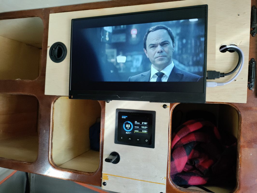

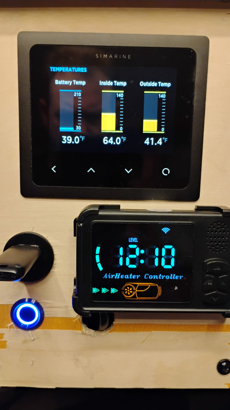

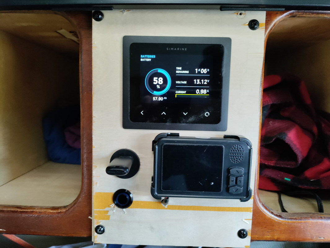

Whelp, I've had some trips fall through over the summer. I was supposed to go on a week long offroad trip, and that was going to be a MAJOR shakedown run of the trailer, but my wife severely broke her foot the weekend before, and has been down for 5 weeks now. Hopefully, we get to find out when the pins get to come out at her appointment next week.
In the meantime, I've been trying to get the water tank sensor working, and I'm not having any luck whatsoever. I've tried a safiery ultrasonic sensor, and can't get it to work. I then bought a converter board for my drop in pressure sensor, and can't get that to read at the sensor module either. I have one more ultrasonic sensor to try, and if that doesn't work, I'm going to give up on tank monitoring for a while.
I've pretty much got the entire entertainment setup installed and running. It's all USB powered, and draws less than 2A while in use. I really love this setup, and so glad I went the USB-C portable monitor route, and USB powered google tv route.
The speakers are a usb rechargable PC soundbar with bluetooth functionality, so we can remove it from the cabin, and put it outside for music, if we want. I also have an HDMI cable that runs from the media player to the back of the trailer, so that I can plug in a projector, and control it using the media player box.
I did notice that without a way to turn off the power to the google tv, I had about a .6A draw that never went away. So, I added an inline power switch. I also took the opportunity to pre-mount and hook up the controller for the heater.
I realize the panel above looks like garbage. This is a temporary panel until I have everything on there. Then I can have a custom aluminum cut, and mounted up there.
I've also been working on the diesel heater build design, and will have all the parts here to start building that this week.
I also just ordered 400w of solar to put on the trailer. Hopefully, that eliminates having to worry about charging, like....ever.

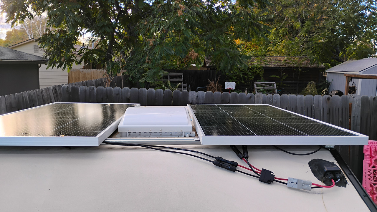

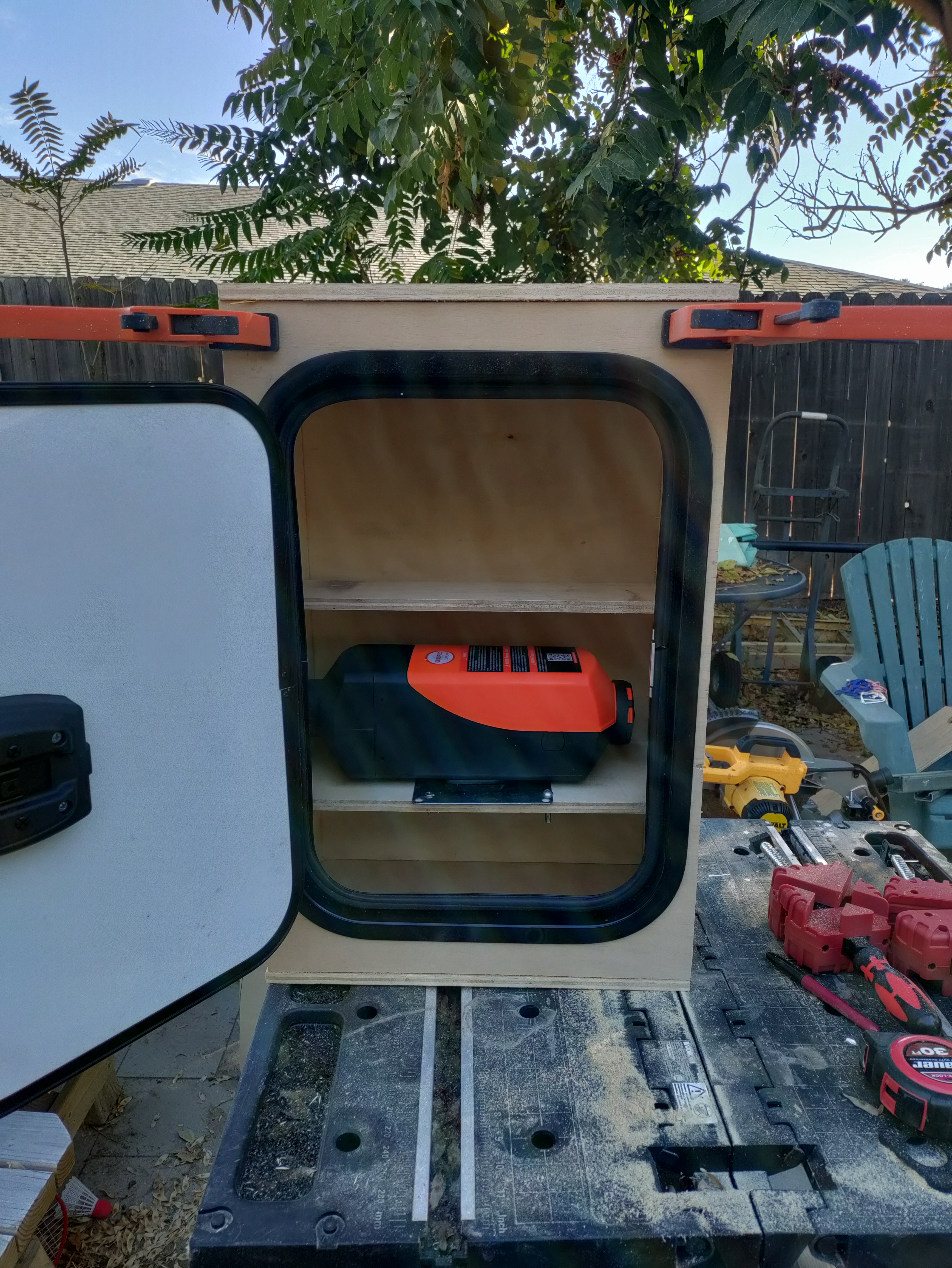

Solar panels came in on Thursday. I managed to set them on the trailer, and was getting about 10-11A in what is basically winter sun. I'm curious to see how it performs during the summer months, but I'm honestly very happy with that. I went from 17% charge to 77% by the time the sun went down. Not bad, I say!
I just need to get some more super strut, so I can make some slightly longer crossbars.
Today, I started building the heater box. Got all the panels cut, and the heater shelf installed.
I had to order a different set of sp21 connectors, as my soldering skills are hawt garbage. The replacement connectors will be here Tuesday, and use screw terminals for creating the connections. This will be a 14-5 wire bundle. It will carry power/ground to the heater, as well as the signal for the controller mounted in the cabin.

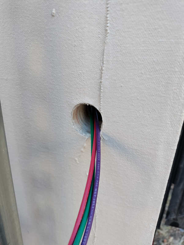

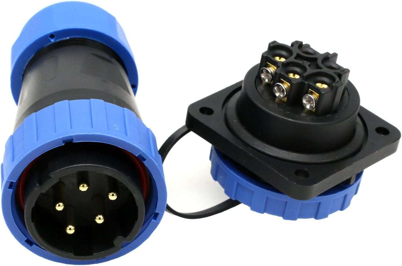

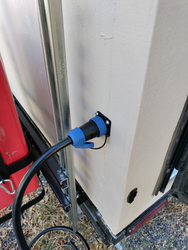

Got some more work done on the heater box this weekend.
First step, and this was a hard one....was to cut a 1 1/8 in hole in the side of the trailer for the plug connection.
I went with a TY28 aviation style connector, specifically the one linked here:
I next got the wires connected, and the plug mounted to the trailer.
I then worked on getting the box mounted to the side rails of the trailer. My superstrut system is working wonderfully!
Getting closer to having the box be usable. I just need to figure out why the fuel pump doesn't want to prime. I've got another harness on order, as well as a magnetic duct coupling. Want to wait until I have the heater fully working before I close up the box though. Once I get the box closed up, I'll run the router around the edges to even everything out. I might even try to round the corners to make wrapping the canvas for the PMF a bit easier. I'll have to think a little more about that one though.

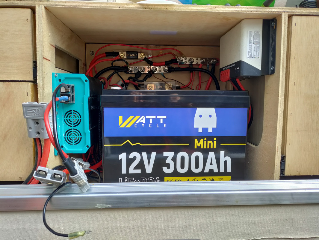

Whelp....looks like the trailer battery is getting upgraded to 300Ah. I was only planning on going up to 200Ah, and not until spring time, but I stumbled across a 300Ah battery, with low temp protection, for under $500.....that was too good to pass up.

I also managed to get the new battery in, and hooked up. I'm likely going to move the solar charger to be above the DC-DC, but we'll see. I currently have to take it out to take the battery out, which is required to access the components on the panel behind it.
I also got the new crossbars made, and the solar panels mounted.

Finished the heater box, and got it mounted to the trailer. Tested it out, and it's given me no issues yet. I ran it for a while yesterday, and again for a few hours today, while I did some work on the inside. It was on low, and still got super toasty!
I'm really excited to try this out in a couple weeks. The last mod I need to get done before we go is getting the heating pad for the water tank installed. Should be dry next weekend, so I think I can get that done.

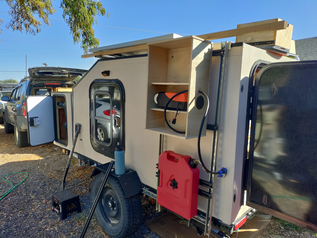

I finally managed to get my tank sensor working. I used a drop in pressure based sensor, that reads out current, wired into a conversion board that sends anywhere from 1-5v to the simarine system. I've not tested it on a trip yet, but we have one coming up in a few weeks, and I'm excited to see how it works.
I've also been doing a little work on the galley. I build a couple of storage units today.
Left to right:
Coleman oven
Cooking utensils
Sauces and spices
I'm trying to think of some other ways I could utilize some of the other spaces I have in there, so I'm sure there will be more things I build.
