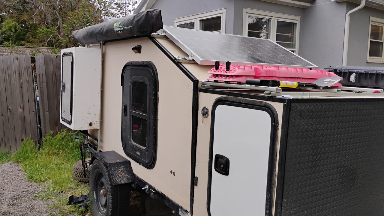

I covered the front of the trailer with a rubber diamond plate, and trimmed 3 sides. The vertical trim is the edge trim that I used on the rest of the trailer. This will allow me to have a rack there as well. I plan on moving the traction boards to the front, and possibly the axe and shovel, if there's enough room. I need to paint the aluminum angle along the top, and get another piece for the bottom.

I also took the propane tank off the fender, and made a new bracket to put it under the stove box.
More fixes and modifications.
Reattached the passenger side fender.

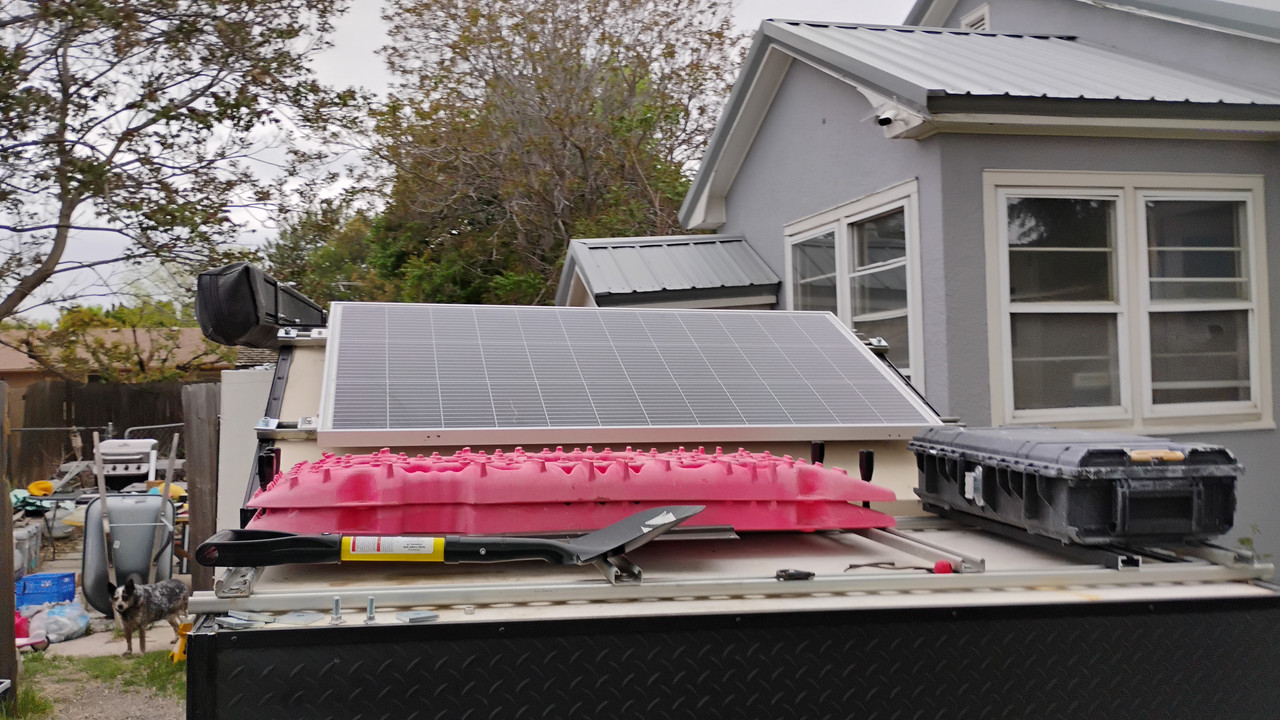

Finished up the new crossbars and got the front solar panel mounted:

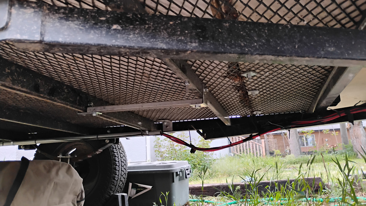

And made a mounting support to put the spare under the trailer. I still need to get a long carriage bolt...
