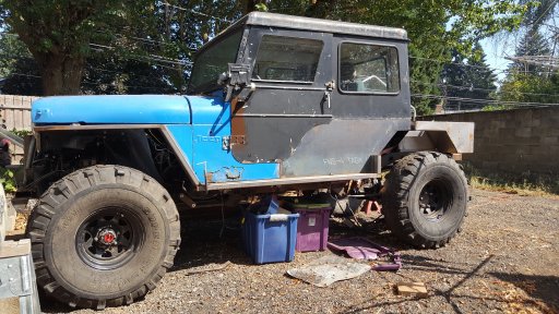

this is the first time I've really stood back and looked at the jeep . It's getting to look like what I have in my head definitely can't wait to get the sliders and fenders built. Going to be moving it over to my dad's house because my buddy just has too much stuff going on in his shop but it'll work out for the better anyway because my Dad's getting on in his age and can't do all the things that he wants to around his house. So while I'm over there getting prodjects done for hin I will be able to work on it a couple hours here and there will be a lot easier than trying to find a half a day or a full day to go to the shop to work on it

It gets better looking every time you post.

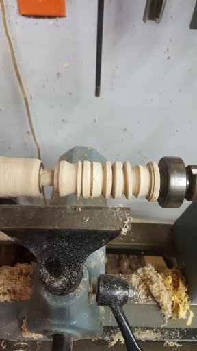

Hanging out in pops shop I decided to take a crack at a little woodworking and played around with the lathe. Never been much into it but with him having a full woodshop i figured it would be a good way to spend a little extra time with him and learn some new stuff . 20180823_140152.jpg

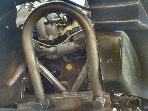

I had to get my hands a little dirty so I cut some sheet metal and got the shock hoop placement and motor mount reinforcement figured out . 20180823_154935.jpg 20180823_154955.jpg

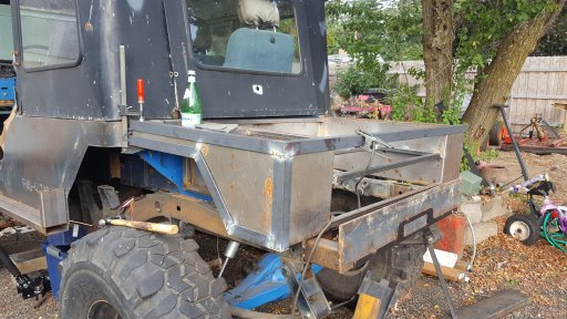

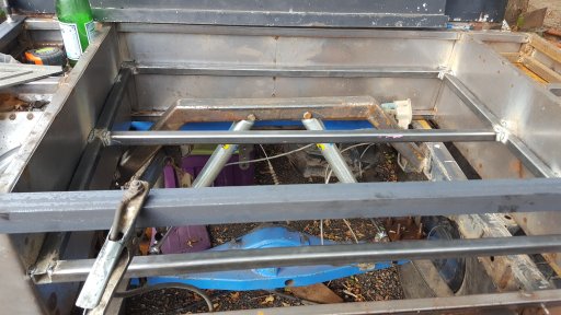

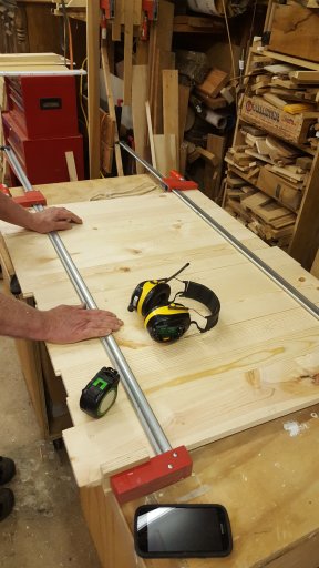

shock towers are almost done just need a bit more welding and some paint , had to get creative on the braces on drivers side due to how long the shocks are .hdr_00858_0.jpg hdr_00859_0.jpg
got the front axle slod forward another 2 inches , made the shackle angle much better
