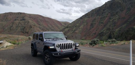

So I picked up another rubi. Was going to get another Jk but used priced vs what I got this for it was a no brainer. No plans for mods right now as it pretty capable, though I'd like throw some 40s on it to piss off the overlanding purists Haha I kid I kid20190518_161533.jpg

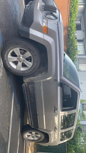

Alright question for all you jeep heads. I have a 2016 Patriot and am considering trading it for a 2002 wrangler with 96k miles, with the inline 6 and an ungodly amount of modifications. Any advice would be greatly appreciated guys! I am also curious how many miles anyone with a TJ has gotten out of that engine. I heard a story about 400k (replacing parts instead of fixing parts on all issues).
