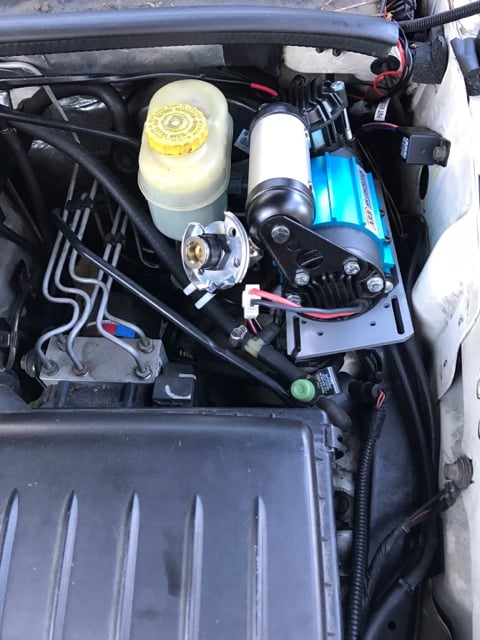

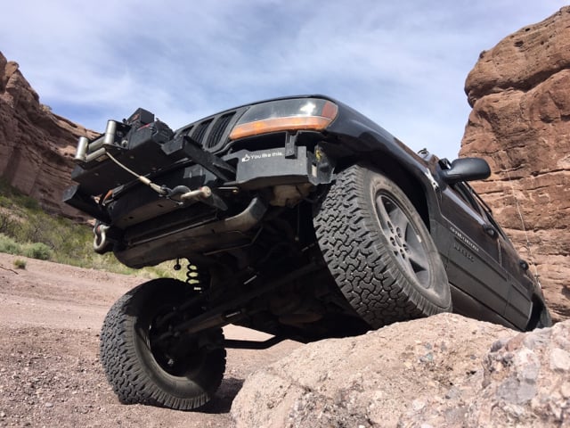

Finally got a break in the rain today to snap some pics.

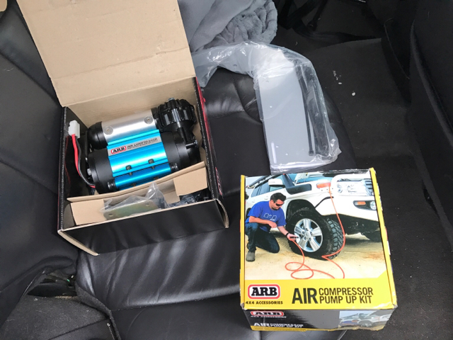

I picked up the nib ARB compressor on OfferUp, they also threw in the pump up kit and a JK synergy mount all for $200.

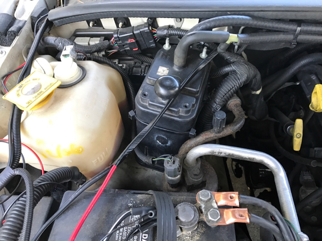

Had to modify the bracket but made it work. Seriously fits like a glove in that pocket after you remove the evap canister.
Which I relocated for now across the engine bay between the a/c hard lines and coolant reservoir.
man that's sweet wish I could move my evap canister to over there but I have some weird module with metal fins on it In that spot.
the search continues for a good spot to mount it lol

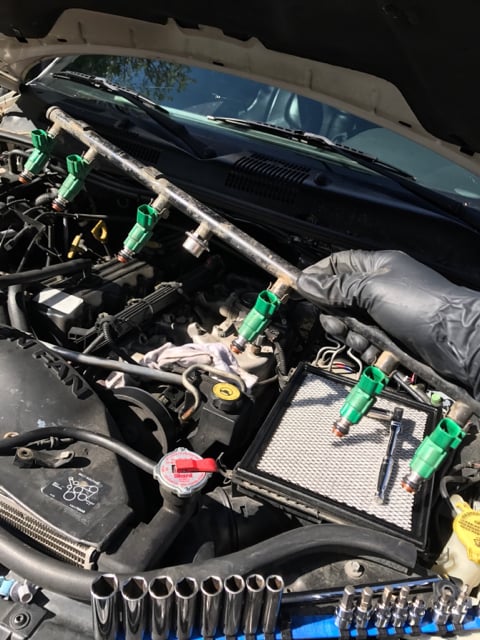

I don't know how many of you guys have the 4.0L, but I just did the Bosch injector upgrade and all I can say is wow! My idle is smooth as butter, engine starts right up and even feels like it gets up and goes quicker. Seems to also maintain speeds on the freeway nicer, I would almost say it makes it feel like before the lift and tires went on. Still putting some miles on to see if I picked up any mpg's but not holding my breath.

Part numbers or what are they off of?

Here's a pretty good thread about them.
https://www.cherokeeforum.com/f2/2000-jeep-injector-swap-questions-85346/
I pulled these guys off a Chrysler Town & Country at the local junkyard and brought them home and gave them a nice cleaning and threw on some new o-rings. P/N 0 280 155 789. Here's a quick YouTube video showing the spray patterns. If you can't find them at the junkyard there are some sites that sell rebuilt ones for something like $140.

I have a set of 24lb 4-hole sitting on the table in the garage. How labor intensive was it?

Super easy, about an hour if you take your time. 8mm worm gear clamp on intake. Quick disconnect on the fuel rail (will need special tool). 2x 10mm bolts and the throttle cables and bracket can be moved, then 6x 10mm bolts holding the fuel rail in. Just remember to pull fuel pump fuse and start it a couple times to relieve the fuel pressure.

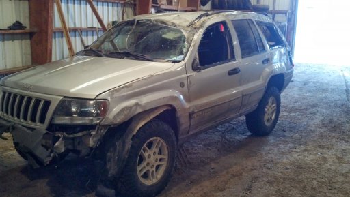

I miss my '04 WJ. A couple years back I hit an icy patch on a bridge, did a 540, hit the guard rail, and rolled down the embankment about 4 or 5 times before it landed on it's wheels. The car was totaled but me and the dog walked away with nothing but scratches. That car was way more awesome than the WK I replaced it with :(
