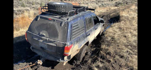

2004 with the 4.7 and QTII sitting on OME HD springs and Bilstein 5100 shocks with IRO extended sway bar end links. IRO high clearance trans crossmember and tcase skid plate (sitting in garage). I have an NP242Hd tcase sitting in my garage to rebuild with a SYE kit. JK 17" wheels with 31" Falken AT3W's. Fawkes Fab shackle tabs with bullbar relocation running a Texas Hunter bullbar with Amazon LED's and a custom tab for the CB antenna. Yakima LoadWarrior w/ extension running an ARB awning on FourTreks mounts. Breather extension in the works. Bout to address the sag in the rear end before much longer. Lots of interior mods.

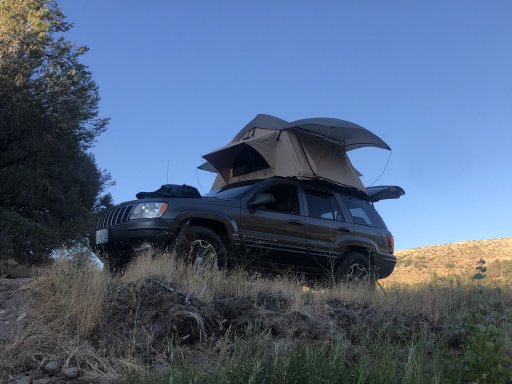

pic from our last family outing

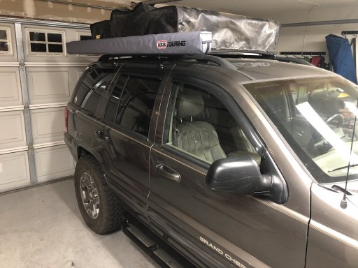

ARB

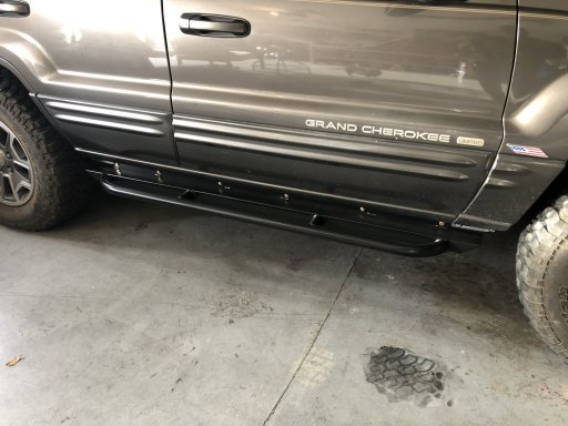

Rock rails

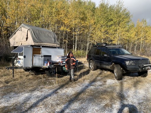

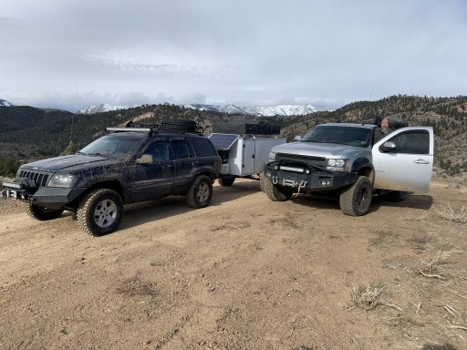

How do you like hauling a trailer with you?
Loaded down it weighs about 2000lbs. It is a bit sluggish even with the 4.7, but it works.
I’ve got a wife, 2 kids, and a dog, so fitting everything in the Jeep is just not happening. Trailer is the only way for us.
We also like to setup camp in one spot as opposed to moving from place to place every night. The trailer I think is better in that regard.
