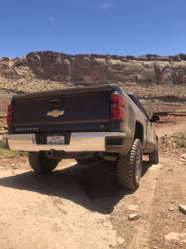

Dirt King Fabrication offers kits around $5500 with King 3.0's in the front and King 2.5's in the rear, that will clear 37", this does not include regearing or wheels and tires, nor installation costs. 2wd Long Travel 2015 Chevy Silverado
On another note I am running 33" tires 275/70/18 on stock suspension, removed air dam and trimmed front wheel well, slight rubbing on control arms at full turn, articulation seems pretty decent. I found it rather capable, took it off road outside of Moab.

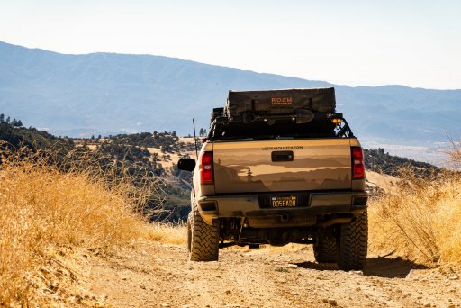

Some Update information...
Changed my suspension to the Icon stage 5 (blew out my stock coilovers on mojave trail and broke my stock UCA)
This lowered me to a 3" lift from the 3.5" I was at. I need to now find smaller blocks for the rear as I have a decent rake in my stance now.
But I was still able to squeeze from 35x12.5 Falken Wildpeaks in there (with a little more wheel well liner trimming and a few zip ties. haha
Added a bit more light also...
