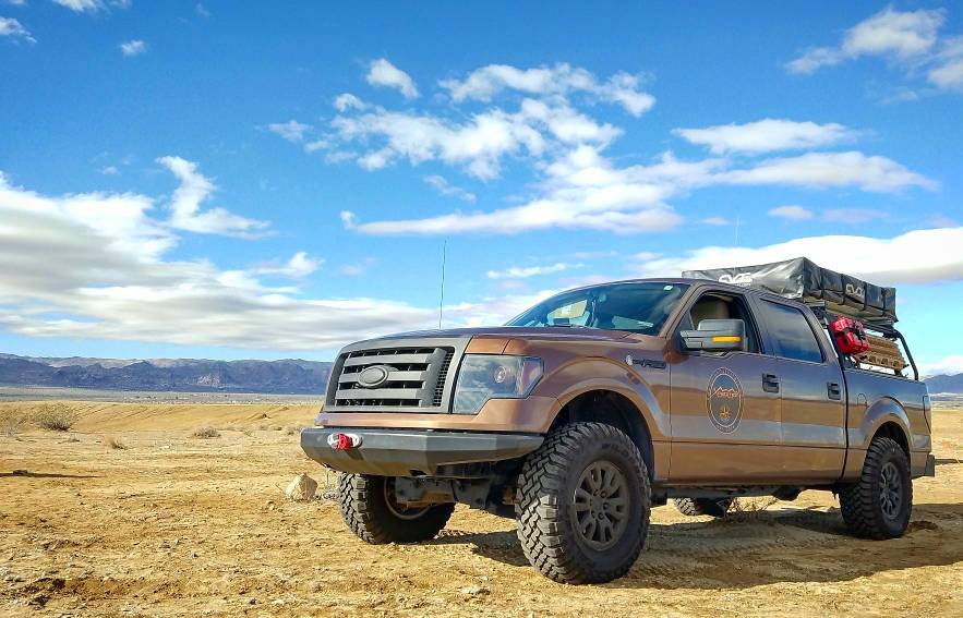

I have ran three different rack setups and a shell. Right now I'm running a leitner design active cargo system with my rtt......
Sent from my SM-P550 using OB Talk mobile app
Is the 1fitty just leveled with rapter wheels or what do you have for lifts? We just got a 150 and thinking about just leveling it at putting rapter wheels in it sense we found tire and wheel for 500. If you leveled it did you have to replace stock upper controls Had a ram that if you leveled the front you had to do uppers too.
Love the look!
