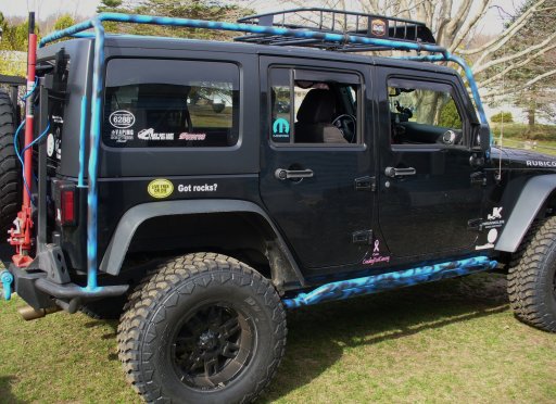

Very nice! Where are these trails?
New Hampshire Class VI roads. Miles and miles of them mostly south of the White Mountains.
The perfect rig is the one you like the most. Even if it's not a built monster, it you have fun in it, its perfect.
I agree 100%. Its as "built" for offroad as it will ever get. Now its just maintenance time. All the mods now to the rig are to get our camp gear in there and stowed good. This is going to be a daunting experience...lol

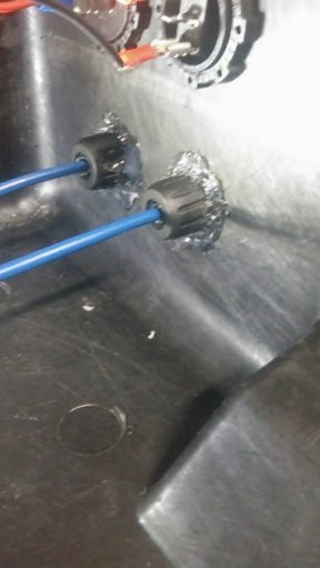

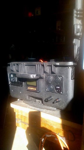

Worked on the solar kit today. I started with an empty Pelican 1650 this morning and now I have the batteries strapped in. I was able to screw the strapping right to the pelican base and was surprised at how tough these cases are. The batteries don't budge.
In the end of the case I have all the outlets and the monitor cut in and installed. Then I built a tray to mount the inverter and solar controller.
I still have to get the wiring done, but the holes are all drilled for it. I also need to get another MC4 connector for the panel hookup to the tote. I had cut the connectors off for testing how this unit would perform and that was the only way at the time. So far I like the way its working out.

This is the tray I built to raise the bottom and mount controller and inverter to.
I hot glued in the MC4 fittings for the solar panel. This kit will never see weather but it does seal the opening just in case.

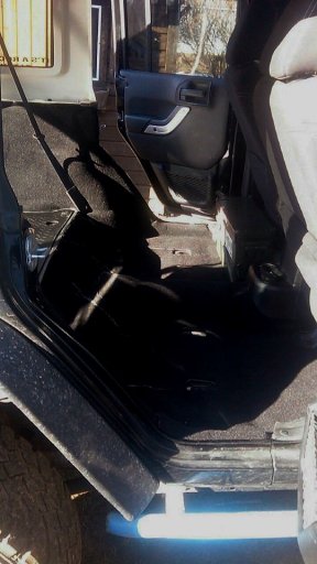

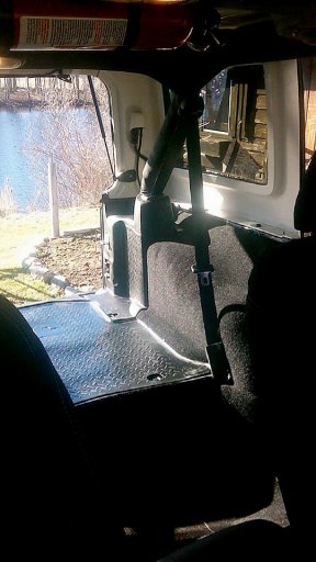

I removed the back seat from the jeep, nobody ever rides back there anyways. With all the camp gear adding up, and the new solar kit, we need the space more than the seat. Plus the seat weighs around 90lbs...good trade off for gear. Now I am trying to think of a good way to mount our first aid kit, shovel, recovery gear and my spotlight that stay in the jeep all the time. Usually they are just bouncing around on the floors.
Love it without the seat, open floor plan now ! :sunglasses:

So today Cara and I built this deck to level off the floor to store some camp gear a little better. The floor was all crazy uneven after removing the rear seats and nothing would sit good. A couple short pieces of 2x4, some 1x3 pine, 1/4" plywood and some indoor/outdoor carpeting...problem solved :smile:
