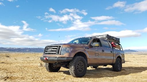

Hello Everyone,
New Member and looking forward to learning and sharing. I'm in Southeast GA about an hour North of Savannah. Well versed in Survival, Prepping, Camping, etc. Lots of Offroad adventures growing up and time spent in the outdoors hunting, fishing, camping and practicing survival skills. Born and raised in a once-rural town in NC. Been in GA for about 3 years. Very Rural and I love it. Currently working on building out my 2011 F-150 FX4. Always has been a solid dependable truck and looking forward to setting it up to further my adventures and fun. Plans over the next few weeks is adding a Leitner Designs ACS Forger rack, RTT, Decked and accessories. Hopefully testing next month for my HAM license. (If the "Rona" going around doesn't cancel). My goal for my build is to have a well rounded set up for the adventure, bugging out and assistance with Natural Disaster relief (such as Hurricanes etc). I enjoy assisting my community in a time of need. Purchased membership earlier today, awaiting member #. Again looking forward to learning and sharing. I hope to find some folks in Southeast GA who are into the same and hope to one day be able to find the time to venture out of GA and enjoy time with others who I may meet on here. I hope everyone is staying safe during this time and YEEHAW!
I have finally started the build last night. Starting things off with a Leitner Designs ACS Forged System with some Accessories. Install was easy. Took about 3hrs or so. I took my time and it all went great. The fit, finish, and engineering of this thing is A++. Built like a tank. I think I'm in LOVE LOL. Ill have Vidjas of this build as it goes on too on YouTube. Next up is a Decked System and RTT. Maybe not in that order but we will see. This site is AWESOME by the way. Glad to be a part of it.

Here is my bumper. It's made by mercenary Offroad. But I have a 5.0. You will need to relocate your intercooler if you want a winch in the bumper.
