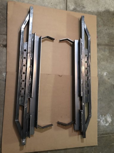

As for the weight in the back, most of what I built was aluminum and pretty light. That said, I’m about to throw some heavy sliders on. Will let you know if I need to switch to HD after that.
