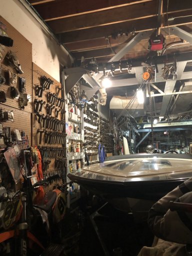

In my favorite experience with this truck so far, I found a driveshaft specialist that runs a shop out of his garage. Nights only. In San Francisco. That’s not normal around here. And it was awesome. Got my driveshaft dialed in and about 90% of my vibration is gone. I think at some point I’ll need to remove and replace the front output bearing to get rid of the rest, but I’ll save that for a few weekends from now and be happy with the the results after all the trials and tribulations with this shaft.
