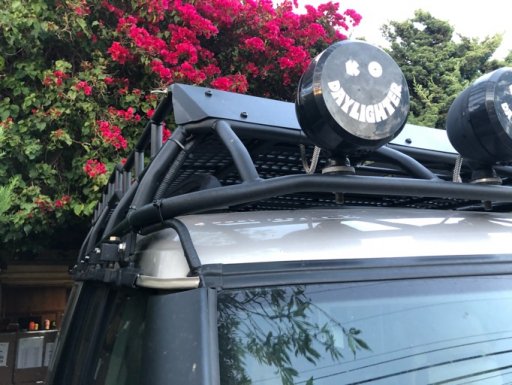

I’ve got a buddy that is trying to wire his safari rack lights. How did you run the wiring from the lights into the cab and engine bay? Any details including photos would greatly be appreciated.
Curious on this as well.
I have 4 Hellas I need to mount. I was planning on running down the A pillar into the engine compartment then into the cab via a negative-switch set up. Going down the pass side makes plenty of sense. The problem is those A pillar covers getting ripped off on the trail despite limb risers.
I saw that @Michael has a nifty water tight connector he used for routing his old Hellas. Goes from the roof into the cab. Not sure if he still did that with the KCs. I think there’s an older OB vid about it.
I ran it down the passenger side A-pillar. It’s a super tight fit. I have loom at the top, no loom under the A-pillar, and then start the loom again as soon is it comes out of the A-pillar and goes through an existing wiring hole to the engine bay.

Realize I didn’t totally answer your question! Here are some pics and more detail:
I ran it down into the a-pillar like so(broke a bit of my roof gutter on the corner as you can tell).
I then ran it into the engine bay like this:
Ran it across to the driver side like this:
Down into the drivers side of the bay like this, through an existing boot into the cab down by the pedals:

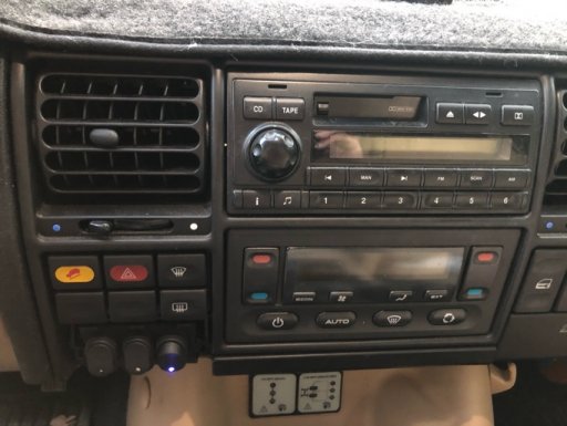

I then ran it over to the coin tray, which I pulled the front off and drilled through to install switches:

Nice install! Very clean. How did you mount the switches on the coin tray?
