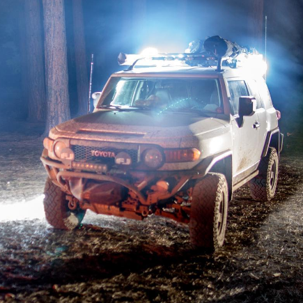

We asked Overland Bound Members to tell us about more about their vehicles, and how they made their modification decisions. Read on to learn more about what inspired them on their overlanding journey! Each member has different requirements!
What did you modify first?
Steve – Overland Bound Member #0202
Vehicles: 2008 Subaru Outback and 2016 Toyota 4Runner
“On both, tires! Road biased all-terrain Geolandars on the Outback, and BF Goodrich KO2s on the 4Runner with 50 miles on the odometer. Tires, because that’s the best bang for the buck on any non-paved surface when compared to stock tires. On both vehicles, this simple improvement opened a huge range of places I could go.”
βWinterpegβ – Overland Bound Member #2861
Vehicle: 2008 Toyota FJ Trail Teams
“First was a winch. I like to βOutfit and Exploreβ and make it back. My previous 4×4 did not have a winch and I got into a LOT of trouble with my wife because I was late for supper due to being stuck on a βquickβ little detour on the way back home. Four hours later, and a long distance call to a friend to get me out, I was home. This was almost a decade ago and I STILL hear about this⦔
Jeff – Overland Bound Member #0327
Vehicle: 2007 Jeep JK (2-Door)
βLighting. (Itβs a) cheap and good way to learn about the simple parts to take on and off.β
Mason – Overland Bound Member #0364
Vehicle: 2010 Toy FJ with Off Road Package
βTires and suspension – BFG AT. Road behavior with the BFG AT was bad (My FJ did not like them), so now I run GY Duratrack and they work very well. The street stock tires just did not work.β
Kevin McC. – Overland Bound Member #0102
Vehicle: 2014 Toyota 4Runner Trail Edition
βWe cut a factory tire down on our first trail and promptly made our way to the tire store the very next morning for a complete set of BFG KO’s All-Terrain tires. Since this upgrade, we have NEVER had another flat.β
JDunk – Overland Bound Member #0446
Vehicle: ’06 Jeep XK (Commander)
“Lift and tires was the first thing. The XK is basically a massive station wagon from the factory: long
wheel base and comparably short ground clearance.”
What is the biggest factor in your decision making for what and how much you spend on your rig?
Jordan B. – Overland Bound Member #0750
“For me all initial mods/repairs or upgrades were based upon gaining reliability. For me the rig being reliable is most important.”
What are your additional thoughts on this process?
“There are a lot of projects left to do: armor on the undercarriage, sliders, new roof rack, RTT, new lights, on board air… the list goes on and on. It’s a time thing. If I’m always working on the rig, I can’t enjoy it or the world it’s built to explore. Though, budget is a pretty big reason also.”
Long story short, it’s about tires and suspension first and foremost. After that, the sky’s the limit, but be sure to carefully consider the needs of the journey! Head to our forums to ask members directly!
