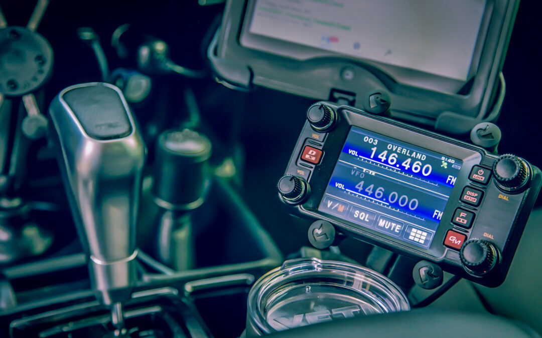

  1. Handheld or Dash CB – Short range inexpensive widely used radio
  2. Handheld or dash HAM – Long range comms, license required
  3. Delorme In Reach – Satellite comms + txt off the grid world wide
What we use:
