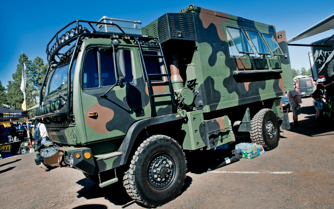

A twenty-two thousand pound ex-United States Military M1079 LMTV truck named Brutus does not exactly sound like an anniversary gift that would get a ringing endorsement, right? This is exactly what Kande Jacobson of Adventure Driven asked of her husband Seth, and it’s a thing of beauty.Brutus started life as a contract built Austrian Steyr 12 M 18 military truck. Stewart and Stevenson constructed the LMTV, along with its 16 other platform variations for the U.S. Government as two-and-a-half-ton and five-ton cabover trucks. These vehicles were designed to replace the increasingly old M35A2/A3 “Deuce-and-a-half” and M809 five-ton trucks.

A cot in the back and half a dozen action-packers is not something you can live out of for a long time. Goose Gear of Long Beach, CA was contacted for a custom cabinet and kitchen build on the inside of the truck. Gorgeous birch cabinets host a plethora of gadgets from cookware, to a pull out pooper and all the amenities in-between. A 1300 watt Northern Arizona Wind and Sun solar array on the roof plumbs power to the trucks electrical grid and 600 amp-hour Battleborn Batteries lithium-ion battery bank.KC Hi-Lights adorn just about every surface of the vehicle from headlights, to auxiliary and scene/work – Brutus has the light output of a small star, and the 18,000lb Come-up winch has a gravitational pull like one, too.
Suspension was upgraded in the form of custom built three-inch Icon Vehicle Dynamics shocks with external bypass reservoirs to make the 22k pound monstrosity float quite unlike the teeth rattling dump truck it could have been.It is a work in progress, and is something that will probably never be finished. Sounds like madness, but Seth and Kande have their reasons. The platform is the perfect start to what is ultimately, the greatest go-anywhere RV they could ever dream of – military might and capability but available to the civilian market.
