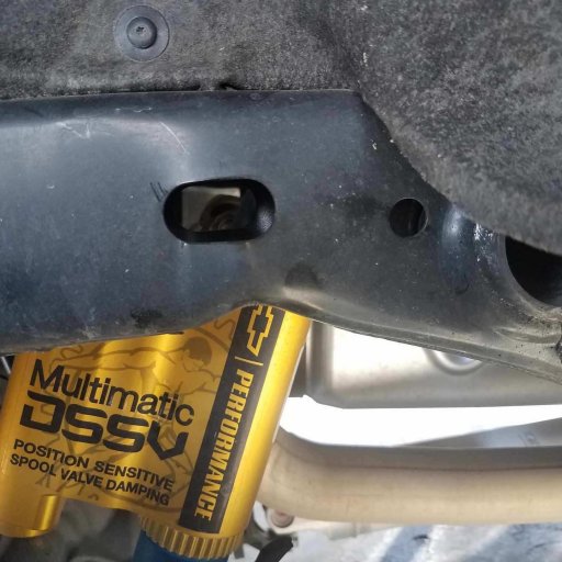

But this is turning out be a Chevy design problem. I've seen 5 others with the same bent frame. None of them were actually "jumping" the truck. They just hit a dip or speed bump a bit quicker than normal. But no one else in the group bent their frame.
It seems to be this hole at the cab/box/shock mount junction where the frame bends.
Time will tell if this is a serious problem..... or just driver error.
So far it seems to be design related.
I hope Chevy comes up with a simple fix soon.
I think its a zr2 issue ive never seen this with the normal colorado z71. Thats where the cab meets the bed right? Ill have to look later if i have that hole in my frame, if so ill box it in with some 3/4 steel.

I can see the frame being bent DOWN in the middle...what the hell causes that?? Looks like it was jumped and landed straddling a big tree stump
Could be that but It was likely jumped and landed on another whoop in the rd, ive also seen it happen when trucks are having a tug o war contest bend up or down from the torque of the other truck vs torque of bent truck usually there is already a crack in the frame from jumping stuff, i guess people who want to jump just have to learn the hard way why trophy trucks have a chromolly tube chassis.

If they all bend in the same place it is definitely a design flaw. The frame in the picture seems a bit narrow to me. If I had one I would definitely have it plated under the dip in the frame and up the sides.

HOLY COW. Does look like he landed on top of something pretty big. A normal bend in the frame would be in the opposite direction.
I'm thinking the shocks bottomed out.... hard.
Which might mean they had no compression damping.
Note the "position sensitive spool valve damping" decal.
3 of the 5 I've seen on various forums had the same decal. Maybe the other 2 also they just never posted the picture. These are brand new trucks I cannot believe 5 guys were all out jumping their Chevys. And if I've seen 5 on forums, I bet there are more.
The other pictures of bent frames are on old trucks, think rust and or abuse. But these are brand new trucks.

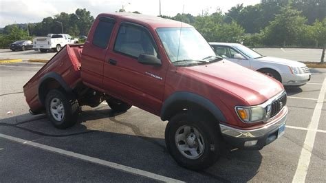

Heres another, not jumping, he just missed the dip, 25mph if you believe him...
the more I see these, the more I'm convinced it is related to the shock bottoming out.

It happens in alot of ways.
Someone failed to reinforce the frame on that truck before they added all that wrecker equipment weight. Therefore the bent frame was not a manufactures design element. The truck was miss used and under reinforced.
