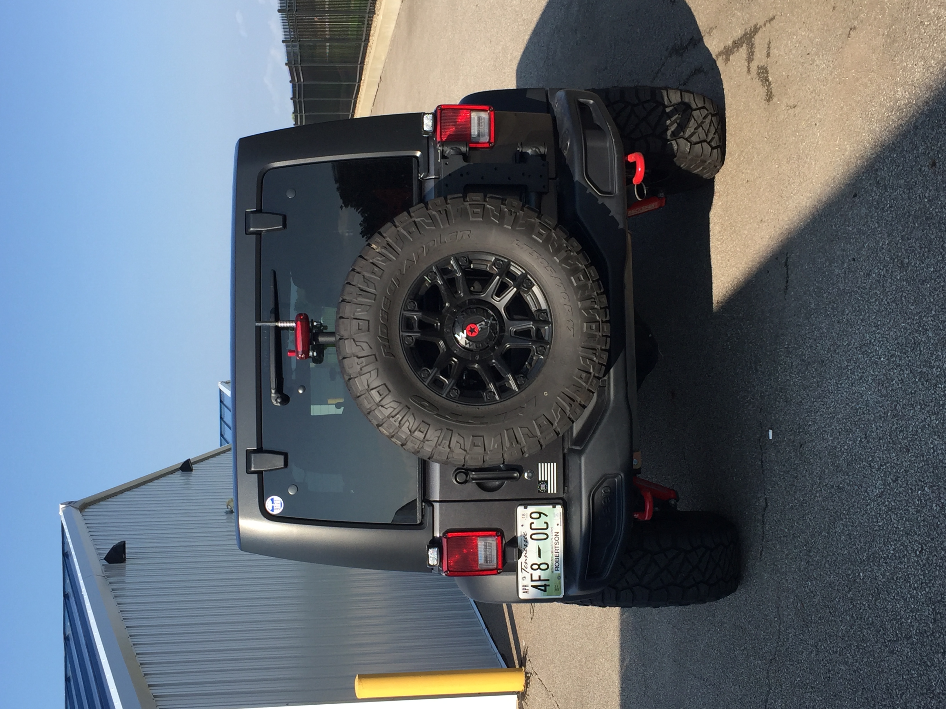

I am new to the Ham radio world and will be taking my technicians test in a couple of weeks. I am thinking about this: for use on the trail in my Jeep Wrangler 4 Door. I currently have a Uniden 520XL CB in it with a 4' Firestick. I have about 1.2:1 SWR across 1, 20, and 40.
I know that if I get the Yaesu that I can run another coax in my jeep for the HT and plug it in where the rubber duck goes. I guess my question is what kind of antenna would work best with this HT? Also, can the antenna or mount be of a spring mounted quick disconnect type that is similar to what my Firestick uses? I live in a condo complex and the HOA has strictly forbidden CB and other types of antennas that are not factory.
If you look at the pic you will see my spring mounted quick disconnect for the Firestick just to the right of the high mount brake light. To the left is another spot where I could mount a Ham antenna. If they need to be separated farther apart from each other building a bracket for that would not be a problem.
Thanks in advance for the help.
